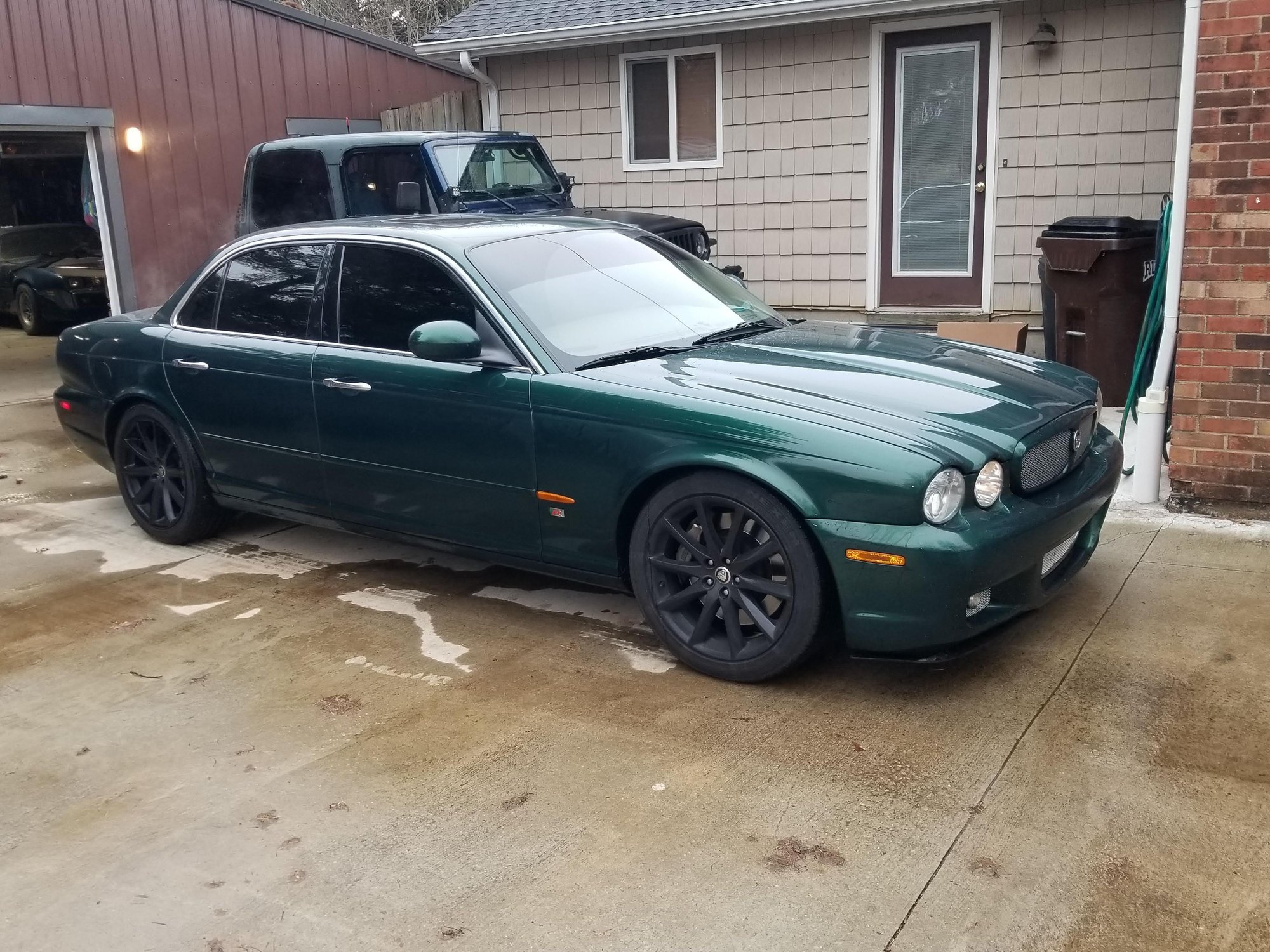

So I have had my 05 XJR for 10 years. 125K Miles. Jaguar Racing Green with X358 front and rear bumper covers, small supercharger pulley, Caldoofy intake. No Catalytic convertors, Center mufflers replaced with a magna flow X-pipe muffler, Mercedes Coolant Pump upgrade and a ford 8.0 posi rear diff. Its a been great car and reliable powerhouse to drive. I made the cardinal sin and drove t through a touchless car wash.
The dash board lit up like a Christmas tree. dash gauges went dead,, park brake fault, transmission fault and the car would not shift out of first gear.
I drove it back to work office and let it sit. It was a warm 78 degree day so it dried out and returned to normal with the exception of the check engine light on, my code scanner will not produce any codes but can clear them. All is good and back to normal. My question is what is getting wet to create this issue? The throttle position sensor? ECU Plug? This happened several years ago when I got caught in a severe down pour. But like this week, it corrected itself. Any input on where i need to look to correct an issue?
