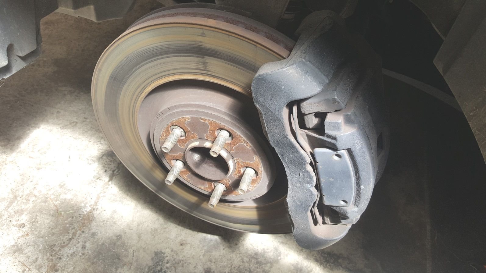

Hi Pete,
The limiting factor on what rim sizes fit is the front brake option. There is a high performance brake option that was usually fitted to Super V8 cars. Your car is a 2008, so it will have the ATE brakes, not Brembo. When this option is fitted, 20" and 19" wheels fit, but I think 18" is too small. My 2008 Super V8 has this option and there is about an inch clearance between the caliper and the rim of my 20" wheels.
Here is a pic of my front brake assembly, if it looks different on your car you will be fine to use down to 17" rims.
2008 ATE Hi-po brakes
Pete M

Whether Brembo or ATE, all supercharged cars, so Super V8, XJR and the Daimler Super 8, have bigger brake rotors than the N/A cars. On the X350, only non supercharged cars can also fit 17" wheels, all the others need at least 18".
If I see it correctly, PeteK, you car does not have a supercharged engine, so it might even fit 17" wheels, but I am pretty sure that 18" will fit.
Does your car have a spare tire, maybe one of the space saver type?. If that one is 18", then your car definitely will fit them.

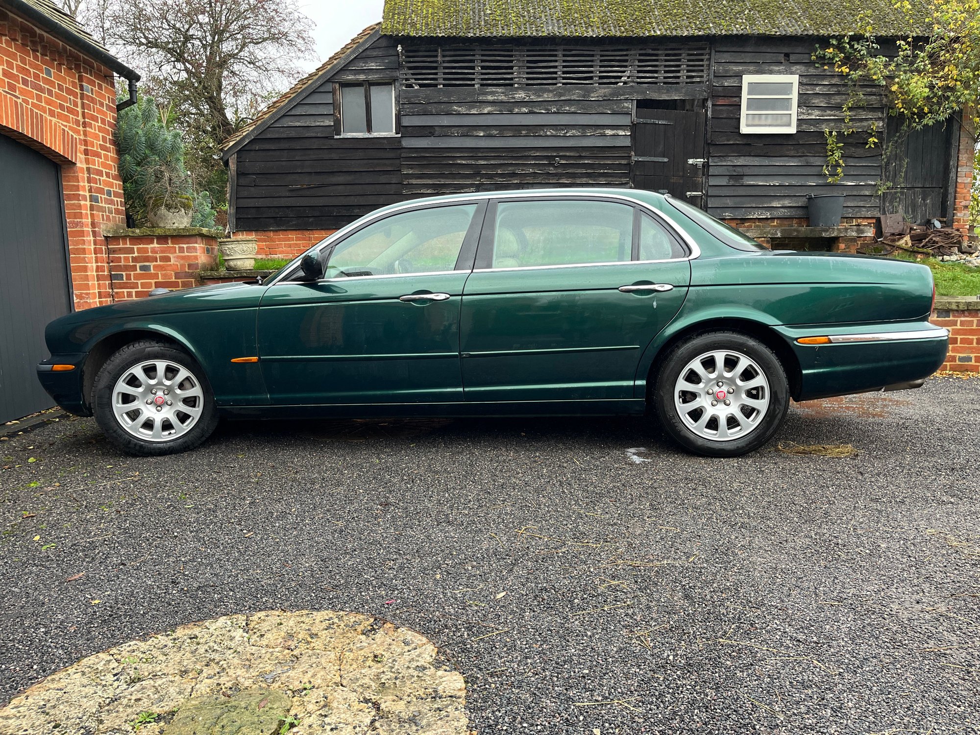

Just fitted my OEM 17” elegance wheels with winter tyres. So much more comfy
than the 19”customs. I quite like the old school look too.

I had a set of those whan I had mt X350 V8. Very comfy, light and elegant.
Not any more fit for the Super V8, 17" wheels are too small...
