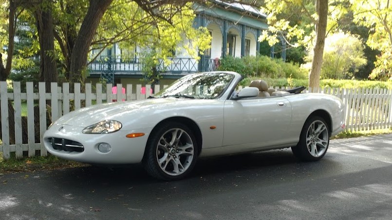

Freezing cold and blowing a storm so I not been out to the garage to look at the wheels but this is the style

Smile Those are 19" Apollo Wheels!
Barry,
Your Wheels are 19" Apollo Wheels. Front size 19"X 8".....Rear 19 X 9"
Your Tires should be: Front - 245/40-19 Rear - 255/40-19 Hey! that's the same size the "idiot" had on it! Well! How about that?
Anything else? Just let me know! Oh! Brand of Tires should be Continental DWS, if you live where it's cold.....If not, get DW's
Billy Clyde in Houston
