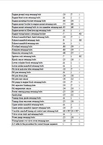

Originally Posted by The Moneypit
..... Am I correct to assume that a Haynes Manual for the X-Type, (also with the 3.0 V6), would offer accurate torque wrench settings for all under bonnet components of the XJ6?
Assumption is a dangerous thing.
From the X350 Workshop Manual:
Attached Thumbnails Workshop manuals & Torque Wrench settings-torque-1.jpg   Workshop manuals & Torque Wrench settings-torque-2.jpg
