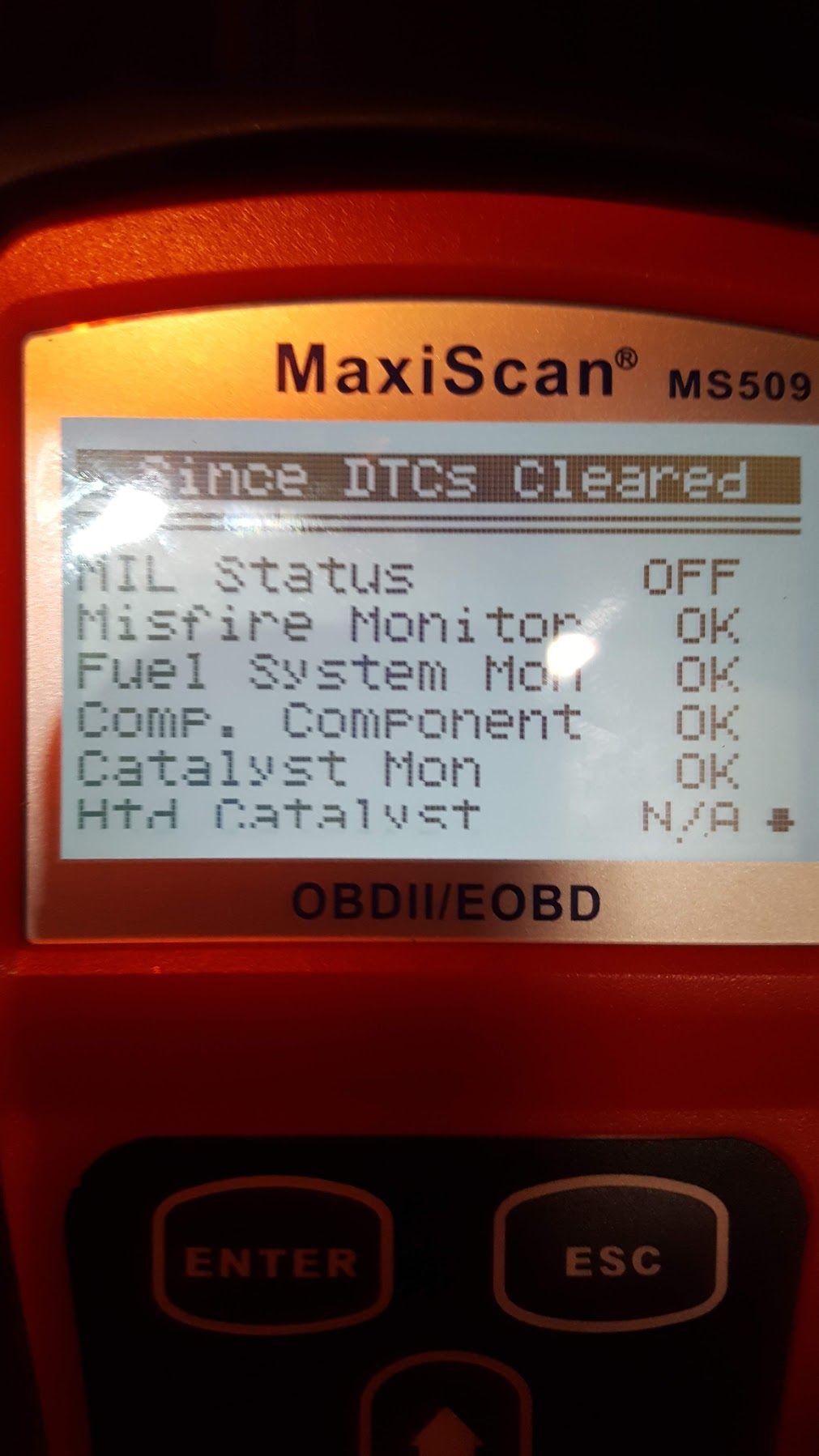

Default pics of code reader
see pics of code reader...the same issue was brought up at inspection so unlikely that the reader is bad
bottom line two monitors that I can't find anything about are not reporting and I don't know what their drive cycle is. thx
