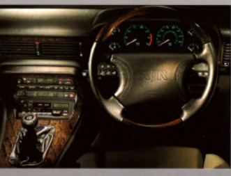

Sorry, the X305 pertains to my car here in the US, its a 1996 XJ12. My understanding is that the XJR, I guess the X350, was not offered with a manual in the United States, however it was available with a manual transmission in the UK and Europe. Most are automatic, but he has seen a number of factory manual transmission XJRs in Germany, Italy and the UK. They command a premium price in the used car market. There is one in Italy right now offered at 23,000 euro, this work-in-progress is offered at 17,000 euro.
This is a picture from a document I came across sometime ago. It's called Jaguar XJ "1996 Range" and is promotional for all models offered that year in the UK. Note the manual gear shift lever. This is RHD; the European market saw the same car with LHD.
I also attached the section covering XJR and XJ Sport from the document.
All that said, it seems that, since it wasn't offered in the US, we here don't know a lot about changing from automatic to manual using the factory correct bits. I'll just wait until he sees the car this weekend and reports back.

Well, that's the point. You either talk about the 1996 XJR Range, then you are in the wrong forum here, or you talk about the X350, which was built from 2003 onwards and was never offered as a manual, regardless of the country it was sold.
Please make sure which model or type you need the information for. Based on the picture and the scan of the brochure you sent, you are in in the wrong forum and you would need to place your question into the correct one. I would have said that the one you need is the one for the X300, where also the XJR was a 6 cylinder engine, and not a V8 as from the X308 onwards.

There was never a manual gearbox for X350s anywhere. You have still not stated the actual model year of the car your son is looking at. XJRs are not necessaritly X350s, as it's obvious from the brochure you posted that there was an X305 XJR, which may have been available with a manual in some markets. Converting automatic to manual is not something I would want to pursue, and buying an incomplete conversion is the biggest Red Flag I can think of, other than a hole in the side of the engine.

Okay, I got it. I didn't notice the year range in the forum header. I think the car is actually 1995, which would make it a X305 as you point out. Thanks for your patience. I'll move the post over there and get the designation and year right.

No problem at all. Just make sure that it really is a X305, because I seem to remember that the X305 is the 12 cylinder, whereas the others, including the XJR, were labeled as X300.
