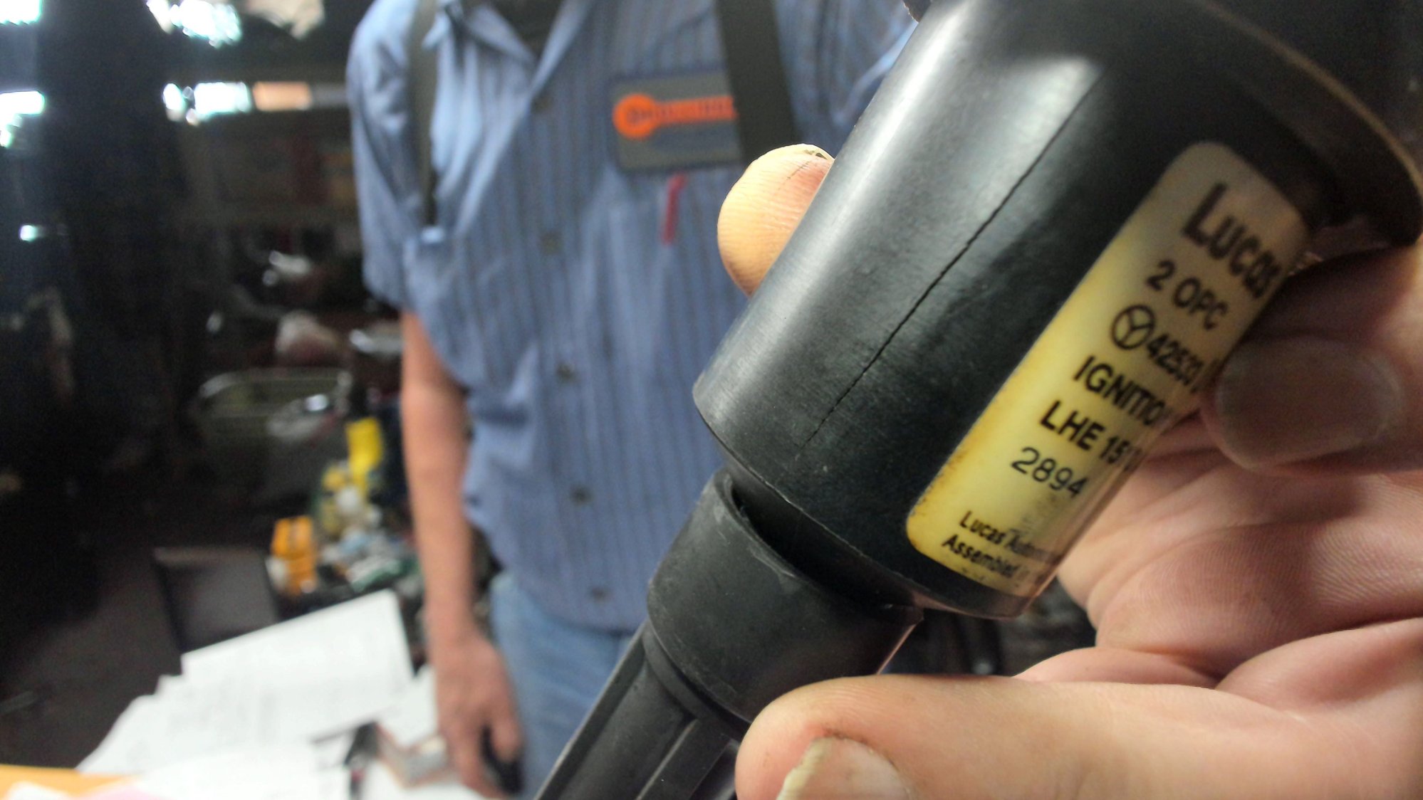

Get QYL brand coils, 80 bucks on amazon. If you had some spare time I bet you could adapt the old AJ6 cam cover onto it.

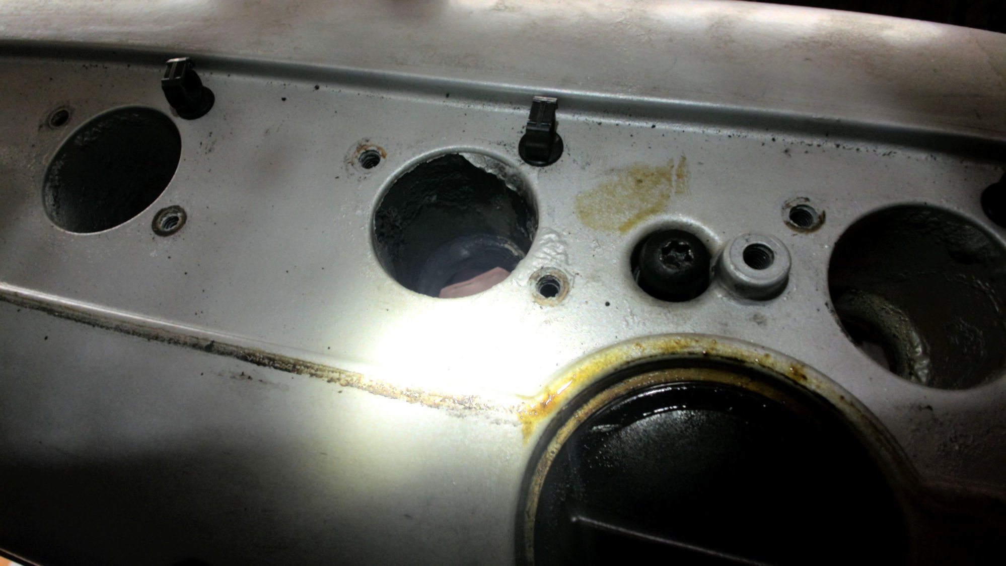

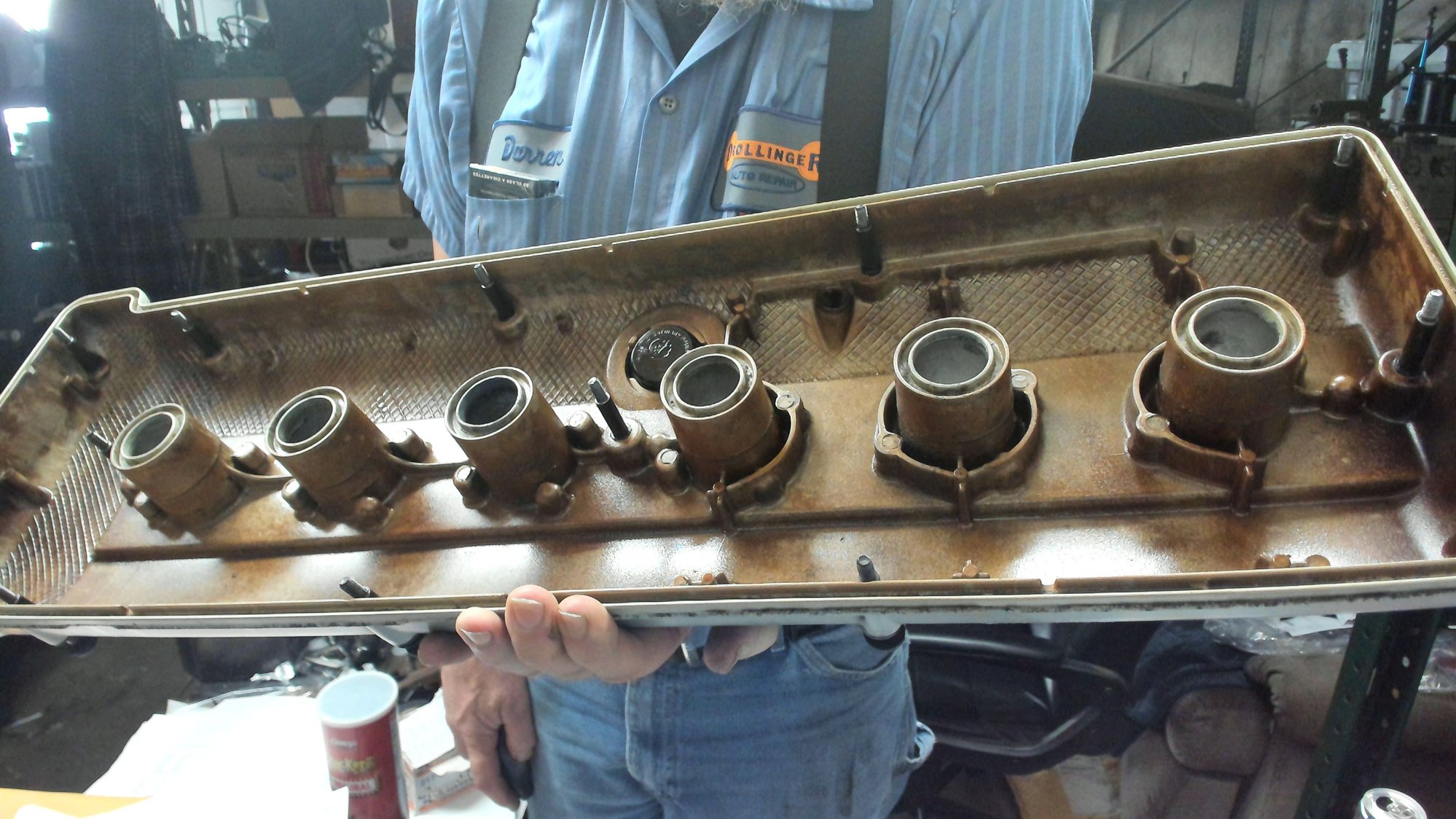

Originally Posted by aholbro1
How much? Odds? I might want in on that action.....
OP, by "no baffle" are you missing the metal plate and everything? or just the course, oil-encrusted sponge-like pads that are stuffed under it?
Here are the pictures of the VC, no baffle nor "fibre sponge" and a fair picture of the worst plug well
VC as removed, no sign of "baffle" ever installed
Hard to see, but corrosion is significant.

For now the cam cover is back on, some of the corrosion was rather deep and in places thru. A little cleaning and epoxy has addressed the leaks for now but will be diligently searching for a replacement. In the interim I contacted a friend who has a laser profiling machine to see about doing a digital file of it and perhaps in the future machine a new billet or fabricated cover. He has in the past made a few one off VC's for me and I must say the craftsmanship was spectacular.
As for the oil vapor separator, cleaned, heat shrink and RTV to help with leaks from the cracks. I also drafted some plans to build a replacement for the separator from aluminum that will do a better job of separating the oil from the vapor and will be able to use more commonly available (less expensive) breather hoses yet fit in the same location.
As for the slight misfire, it is almost completely gone now. I did replace the coils with QYL replacements, All were original with 5 date coded 2594 and one 2894. All were cracked
