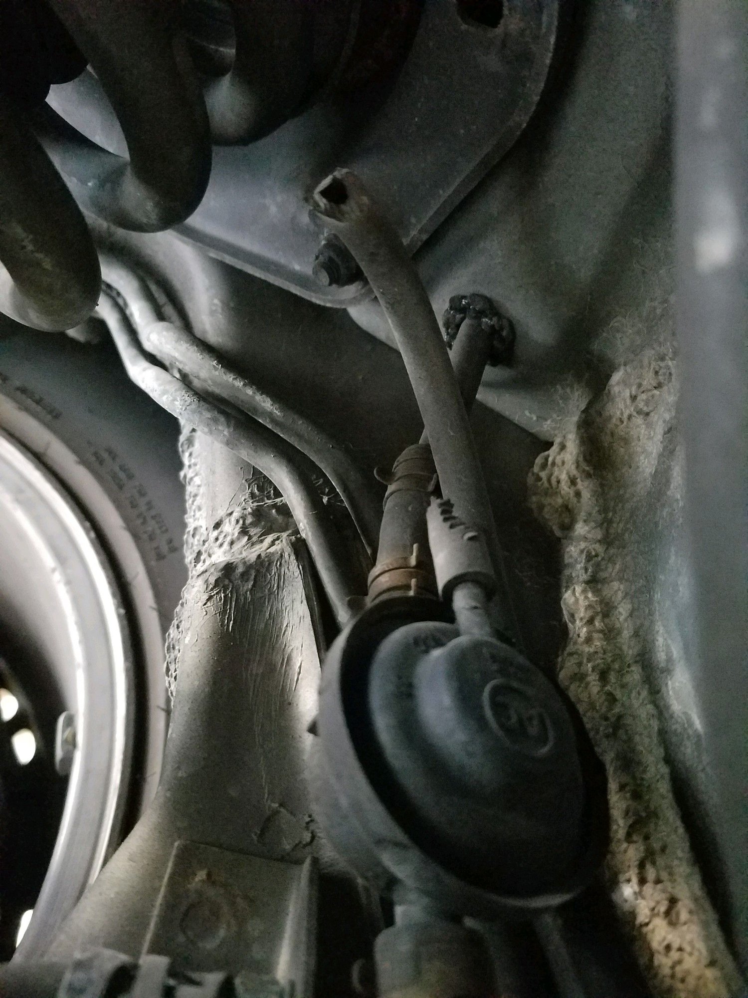

Time for an update on running issues. Previously I had mentioned that after the new coils and oil separator repairs and cleaning the MAF sensor that she was much happier now but still had a very slight roughness at idle.
So today I placed the girl on the lift whilst leaving the engine running. My main reason for raising her up was to inspect the wiring and such for the ABS sensors and also to see why it is every time I do raise her and put her on the ground I get the ABS/Trac Fail/Trac OFF warnings. While looking around I heard what sounded like a happy fuel pump running however it dawned on me that I should not be hearing that from under neath the car. So as I looked up lo and behold I found a gnawed through vacuum line to the canister purge valve which is right next to where the left rear wheel speed sensor wiring enters the floor pan and in front of the left rear suspension spring. A quick trim and re install of the hose solved the last of the roughness.
Canister Purge Valve, 1995 VDP 4.0L
