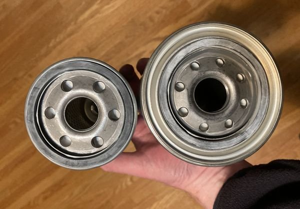

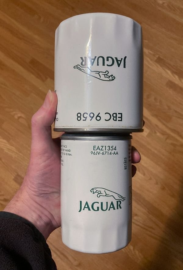

And a trick going back is to use the V8 filter from a 1998-03 XJ8. Same threads and gasket size, but a much smaller body.
