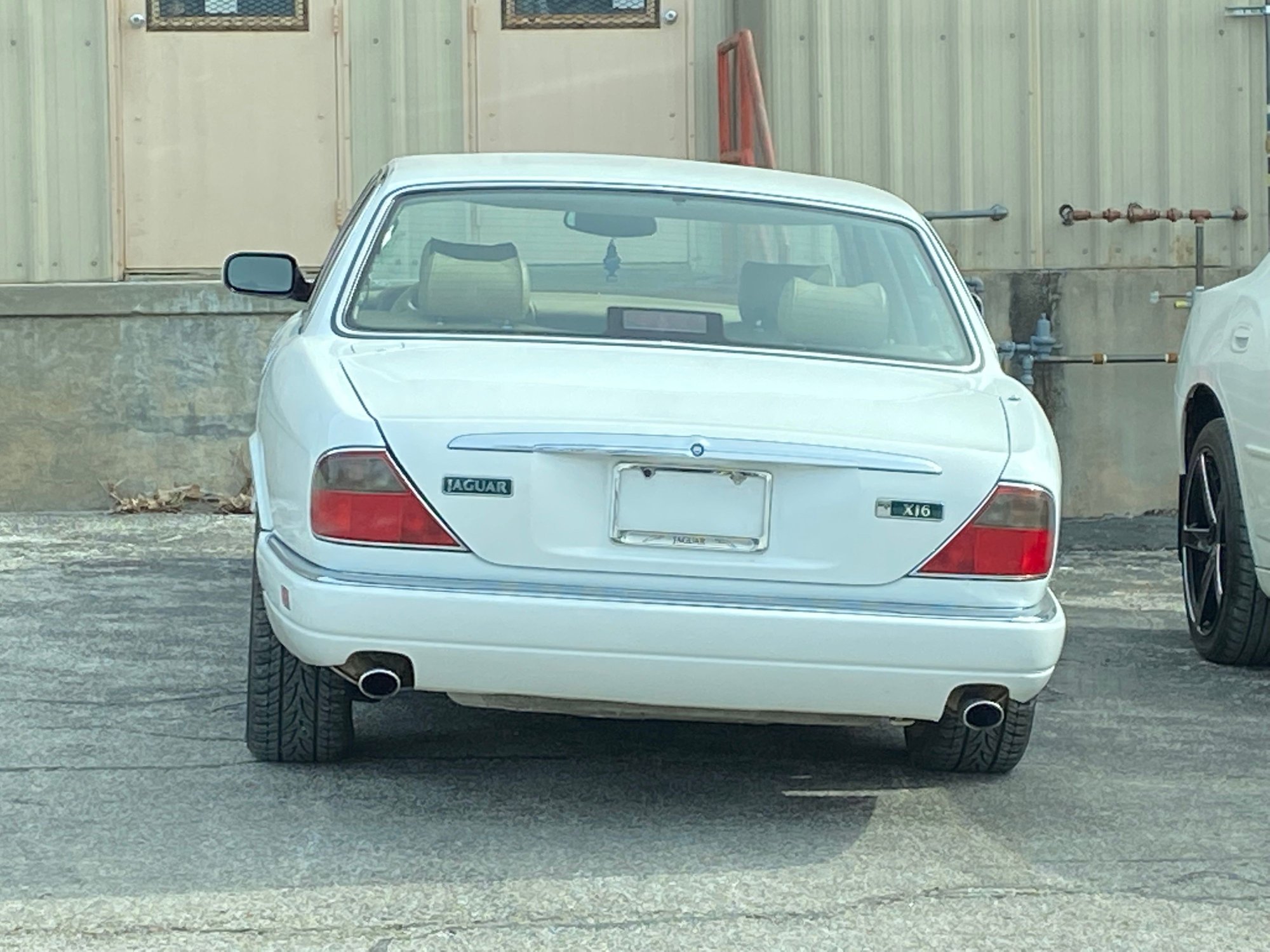

Is this a good year? There is one I could get for 4 K that needs nothing. It is a 9 of 10.
I am tall, will I fit in it. 6’5 and 290..

Yes Richyb8, this is a good year. That car is only 472 later than the 96 XJ6 I owned.
"Needs nothing" is not really believable for a 26 year old Jaguar (or any car that age?). Just from that bad picture I can see that it needs the headliner re-glued. It seems to have an extreme lean to the right! Suspension sag is common.
Regardless, you will be a tight fit in that car. Seat at max down and back. You might fit ok but will want to actually try before buying.

Richard is right. These are great cars but I can virtually promise it needs work. This doesn't necessarily mean you shouldn't buy it. But, be aware and beware !
There's a buyers guide in the "How To" section above, in the sticky threads.

Realistically looks great from the pic, except maybe for headlining. Normally, especially with this car colour you'll see bit of bubbling underneath the rear light where back panel joins rear wings. This looks perfect there but as always first thing to go on x300 is front of the sill from underneath the car where it joins to toe board. If it's ok there it's ok everywhere else and rust is always worst and most expensive to fix so if this is solid underneath, price is reasonable I'd say if you like it.
I'm 6ft3 and I fit no issues but at 6.5 I'd say you won't fit if it's sunroof model and just about fit if it isn't, with seat at the bottom and bit to the back and noone will be able to seat behind you unless a baby in its own seat.
Ideally you'd LWB but I don't think they sold them in US?

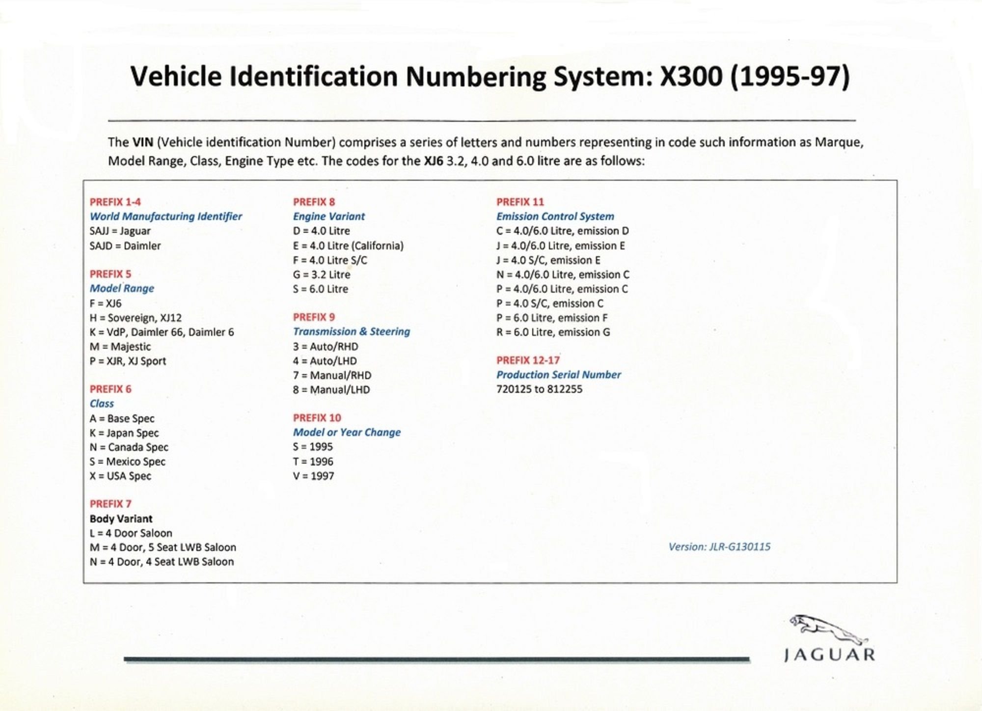

The SWB will have 36 inches on the rear door lower glass edge
The LWB will has 6 inches extra
The extra is all aft of the front seat mounting
The SWB / LWB will be in the VIN # as the 7th # this example being _ so it will be ( something not right )
Should be the letter after X for USA model
Mine is a 1 and a USA model and SWB
According to Doug in post # 14 of this thread there is a separate VIN chart for USA models
VIN DECODE - Jaguar lookup tables - Jaguar Forums - Jaguar Enthusiasts Forum
Click on image twice to magnify
