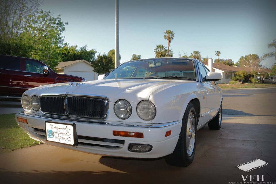

Thinking about buying a 1997 xj6 4.0 107,500 miles 9/10.. owned by older lady, never used car for four years been parked in garage covered.. the son says it needs alternator and battery... California car so four years back fees to pay dmv plus the smog check and repairs.... repairs that i can do myself ..only seen pictures car two hours drive away what would owner wants $1500 but i think thats too much for a 97 needing $$

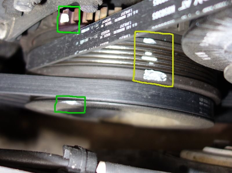

The alternator can be a slipping harmonic balancer not turning the belt to the alternator
There is an easy check , take a white paint marker

You guys are forgetting about the Cali dmv fees/penalty's ...dont have the vin yet, but i bet its around $500 if the HB is ok and the battery/alternator need replacing doing it myself $400 and shop price would be around $600+. then the smog check.. will it pass... might need cats /dont know if the heater/ac work....like buying a storage container ...dont know what your getting... then the value of the jag .....so cdma you would give $1500 for this car..
