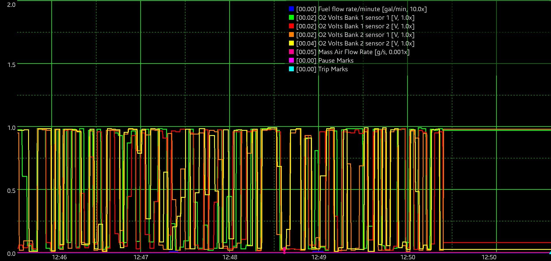

Also, here is what I recorded on my trip today using the Torque phone app, which captured an occurrence of the issue. I've trimmed it to the relevant portion. I took it on a 10 mile trip (5 each way), recording data the whole time. The first 5 miles, from home to destination, were perfect no issues, nothing funky in the data. The return 5 miles were perfect until the final half mile from home, where "the problem" happened one time. A very brief (less than one second) drop in the tach, with a quick "blip" of the CEL, then right back to normal. Here's what the graph looks like, the issue happened right at the 12:50 mark:
1997 XJ6L: Engine Cutting Out/Stalling - Help me save my Jag! [Long]-qijgkea.jpg
This sorta confirms my suspicion that something electric is cutting out the ECM communication with the sensors. The car ran fine for the next half mile, after that half-second cut out, but the OBD did not read any more data from that point on.
Anyone else get a different idea from this?
