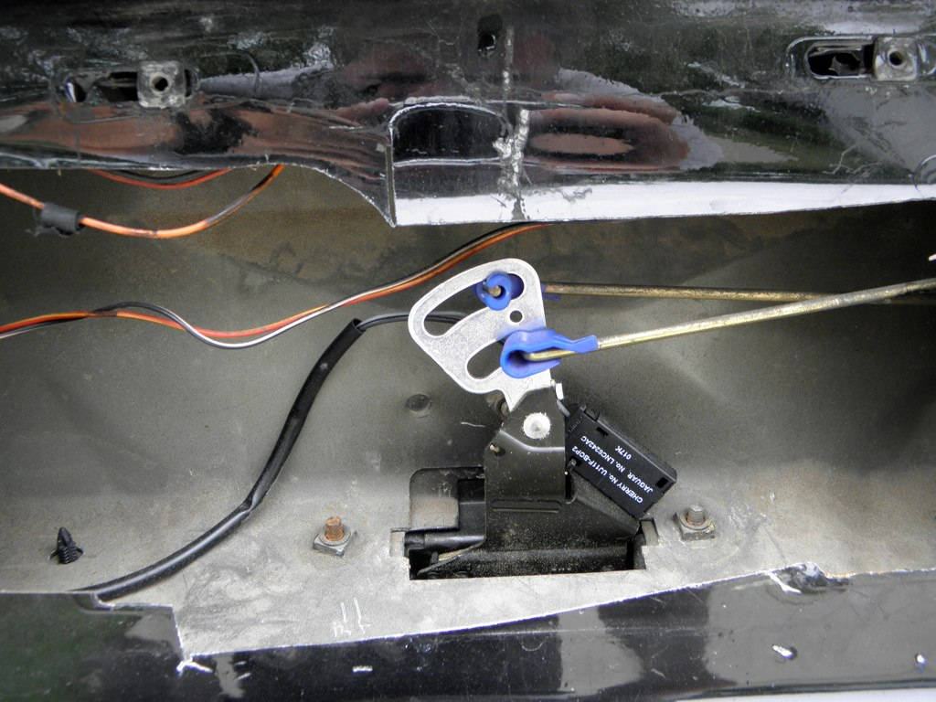

I used a wire hanger with a hook bent on one end.
This is what you are trying to get to....
Old Mar 11, 2013 | 02:27 AM
motomental's Avatar
Joined: Mar 2013
Posts: 52
From: Hillsboro
Thank you!! ;-) everything back to working order.
