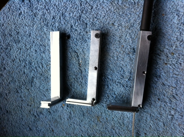

The new accelerator cable anchor is in and I just wanted to share a pic in order for all to see. It feels great and the best part is i can now get the full 100% out of my potentiometer which will allow me to finally reset my potentiometer correctly. The shop made three and made me a deal on them.

yes it goes on the acctuator side of the cable, cruise control. I had the very same problems that you described, could not get 100% throttle, idle would stick at times. I put it together with superglue but it broke after a week. I used my cable for years broken at the end but eventually it gave me problems and I was unable to properly set my potentiometer because I couldnt get a 100% setting, at best it was 90ish. I had no other choice but to have this made as a new cable is no where to be found because they are no longer made. as soon as I get my sc back from magnum powers i will get my car together and reset my potentiometer as i now have full 100 percent throttle. I have only two left should anyone be interested, a good thing is you can use your existing cable, get rid of that broken plastic anchor for a cnc part that will never break.
