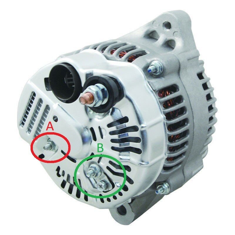

There are 2 components to alternator noise suppression , the 4 diode package inside the alternator and the external noise suppressor . You should hear the noise better on an AM stereo station . You can remove the pigtail connector plug on the noise suppressor ( about a foot maybe from the alternator and see if the noise changes ) . Apparently not all X300s have the external noise suppressor from a contributor that had his missing ( ? ) in England , One of the wires to the noise suppressor is attached to the large B + alternator post , the other wire may have been mis place

Check the harmonic balancer test as an easy look at before pulling alternator , Alt only way comes out from top but the long pivot bolt ( 17 mm ) from bottem . The clevis may pinch and not let the alternator remove , keep track of small wire attached to the alternator housing back ( not round plug ) as noise suppressor ground
