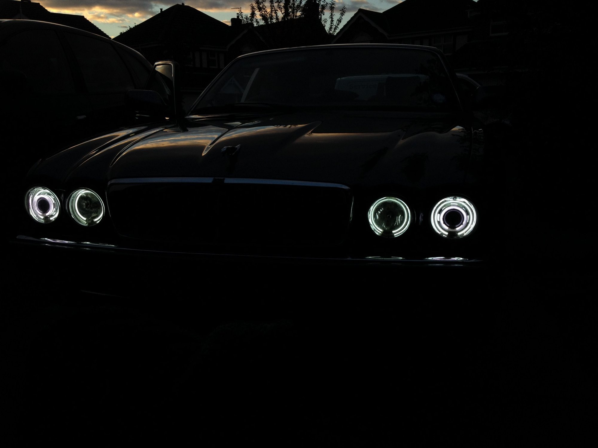

I've been searching everywhere for the headlight size. Because i want to do a custom halo projector setup for my 97 xj6. Here are some pictures of what it will look like whens its done. Anyone know what size the headlights are for a 97 xj6-2657708297_2ff0789683_o.jpg Anyone know what size the headlights are for a 97 xj6-2332315155_266b47905a_o.jpg

Might consider converting over to X308 units ( and mounting bracket ) for the have a much better reflector and the glass may be better and are the same size . 350 headlights are different . Small wiring modification required . Spray some oil into the palls that hold in the unit into the bracket and pry with a long screwdriver . Keep track of the up / down / side orientation before removal . With a darlington switch and electric tea candle led as a triger you can make it twinkle as an option . I planed on making it white switching to red color because it ts a Jaguar ( Jaguar Eyes not Angel Eyes )

i thought about switching to x308s but then i would have risking shattering the glass to put in the led rings so what i was going to do was buy what ever size the headlight with the led ring already installed and cut off the back of the shroud and put the projector in that.

Do the X308 have a seam that can be separated between the glass front and plastic reflector like the X300 ? I was planning on using light diffusing plastic around the chrome ring anyway with very little beam aim wiggle clearance . Wasn't planning on a lot of red lamination , just enough .

I did mine...
https://www.jaguarforums.com/forum/x...lights-137244/
Although added an extra CCFL ring to the outer now
