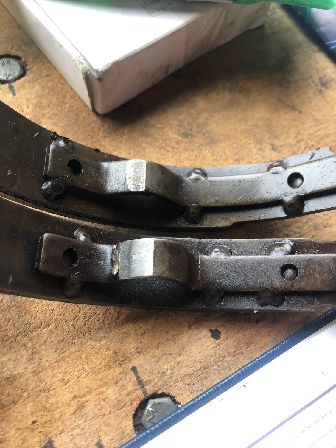

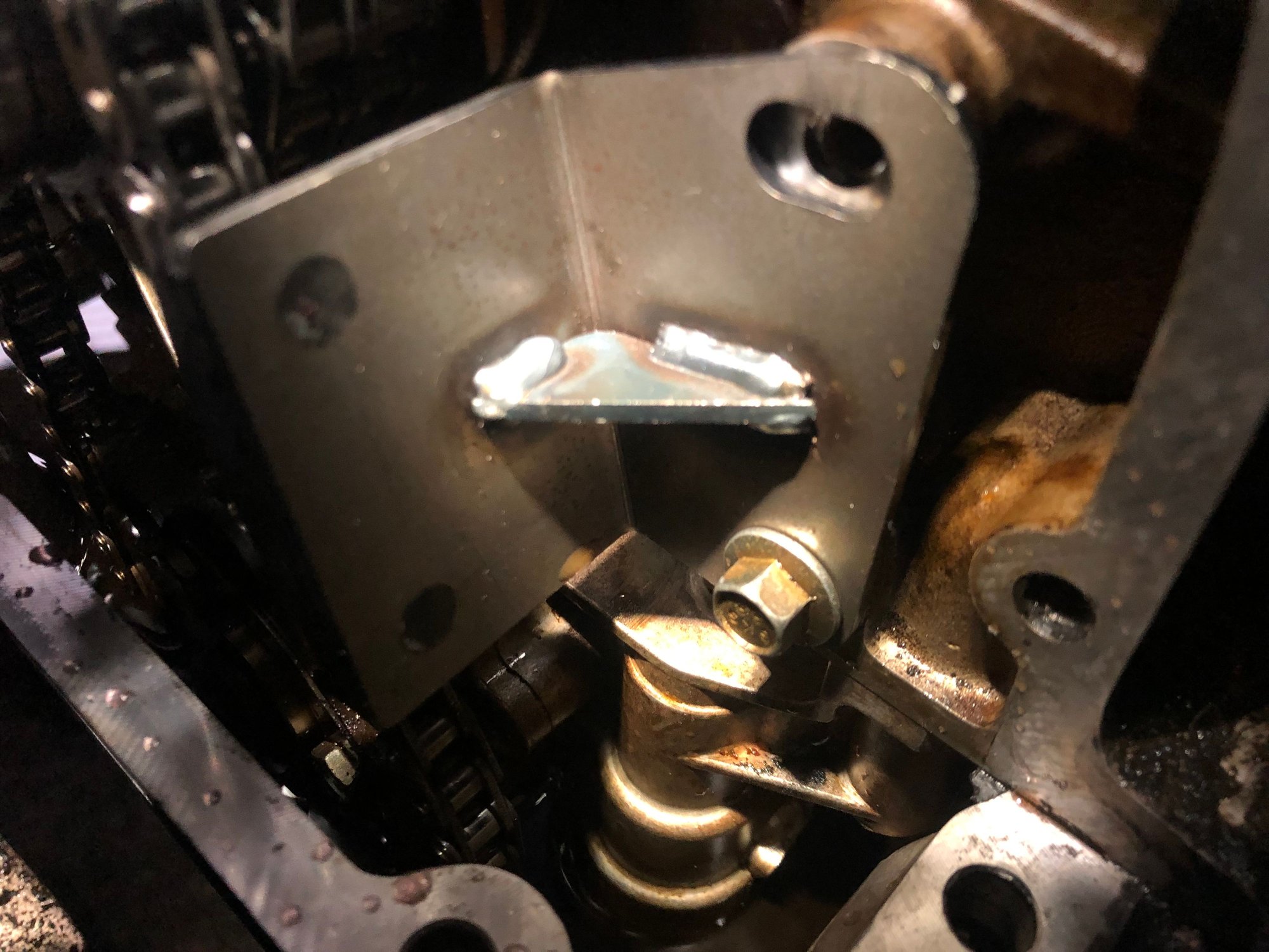

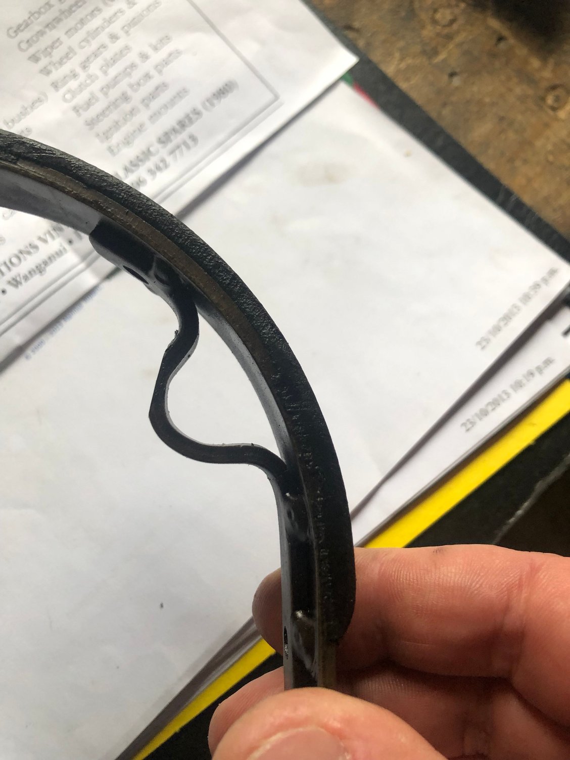

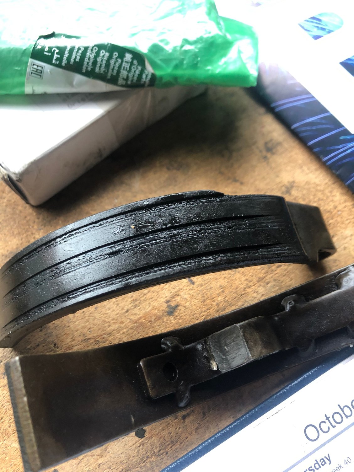

I went to see my car at my mechanic’s place today. Still awaiting the new radiator from the UK.
these photos show the wear in the old chain tensioners, and a new genuine part which is poorly made. It is the tensioner for the chain to the oil pump, and is photo’ed next to the original. The welded triangle brace replaces the pressed one-piece original. It came in the genuine parts bag shown. My mechanic thinks the welds are poor and will not install it. I am going to attempt to find a better one on eBay.
Also taking the chance to renew the ******* octopus hose as it has a pinhole leak at one of the rubber 'welds' where one of the side pumps is joined on.
Hi Al,
I think your mechanic is absolutely right - those welds look awful and incomplete, if the triangular brace were to break free from the tensioner it could cause tremendous damage to your engine.
We once owned a Ford van that had welds that looked like that at a Tee in a short pipe that fed oil to one of the gear sets. When the welds failed at 70,000 miles and the Tee pipe fell into the transmission, oil was no longer supplied to that gear set. As the gears disintegrated the metal bits contaminated the entire transmission. My late father, who designed components for the Big Three and Toyota, said the pipe probably cost $1.50 to make and that that particular example should never have passed quality control. Rebuilding the transmission cost me nearly $3,000.00.
Hope you can find a better tensioner. Looking forward to your next report!

Old Oct 4, 2019 | 03:27 AM
katar83's Avatar
Posts: 602
Likes: 536
From: Cambs
Why not redo the welds? Its a 2 minutes job looking at it and yes they do look pretty awful from your pics.
That was my initial thought, but would the heat have any effect on the way the friction material is bonded ? wouldn't mind knowing as I could see this cropping up for me in the near future.
