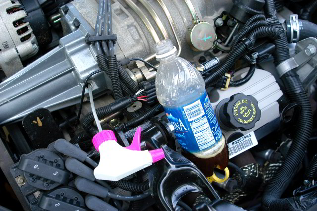

The only motor oil that I have heard of being recommended (though not by the car manufacturers or Eaton) is Redline oil - which has a Polyol Ester basis. I would not use regular motor oil (conventional or synthetic) and use Redline only in an emergency.
I used the GM supercharger oil (GM and Ford also use the Eaton superchargers) - the part number is: 12345982
Takes almost two of the bottles. I used a syringe with a needle (from an ink jet refill kit) to remove the old oil from the M90 supercharger on my XJR6.

Yep, that's a tried/true method for the GM 3800 engines that are Eaton supercharged like my Riviera. I also got a great plastic "irrigation" syringe from my local drug store. Add a small length of vacuum tubing to it and that worked like a charm.
Also, ditto on using the correct oil. I can't personally vouch for the validity of cautions against using something other than the GM oil (or equiv) but the consensus from those that have inquired with GM and Eaton on the GM forums is to only used approved oils and definitely not regular engine oil.
Al
Decided to go with the GM oil. Friend has 750hp mustang cobra that has ran mobile 1 synthetic for 70k miles and Steigmeier (one of the biggest supercharger rebuilders in the country) uses Mobile 1 synthetic but as cheap as it is for 2 bottles of the GM stuff that's what I went with.
