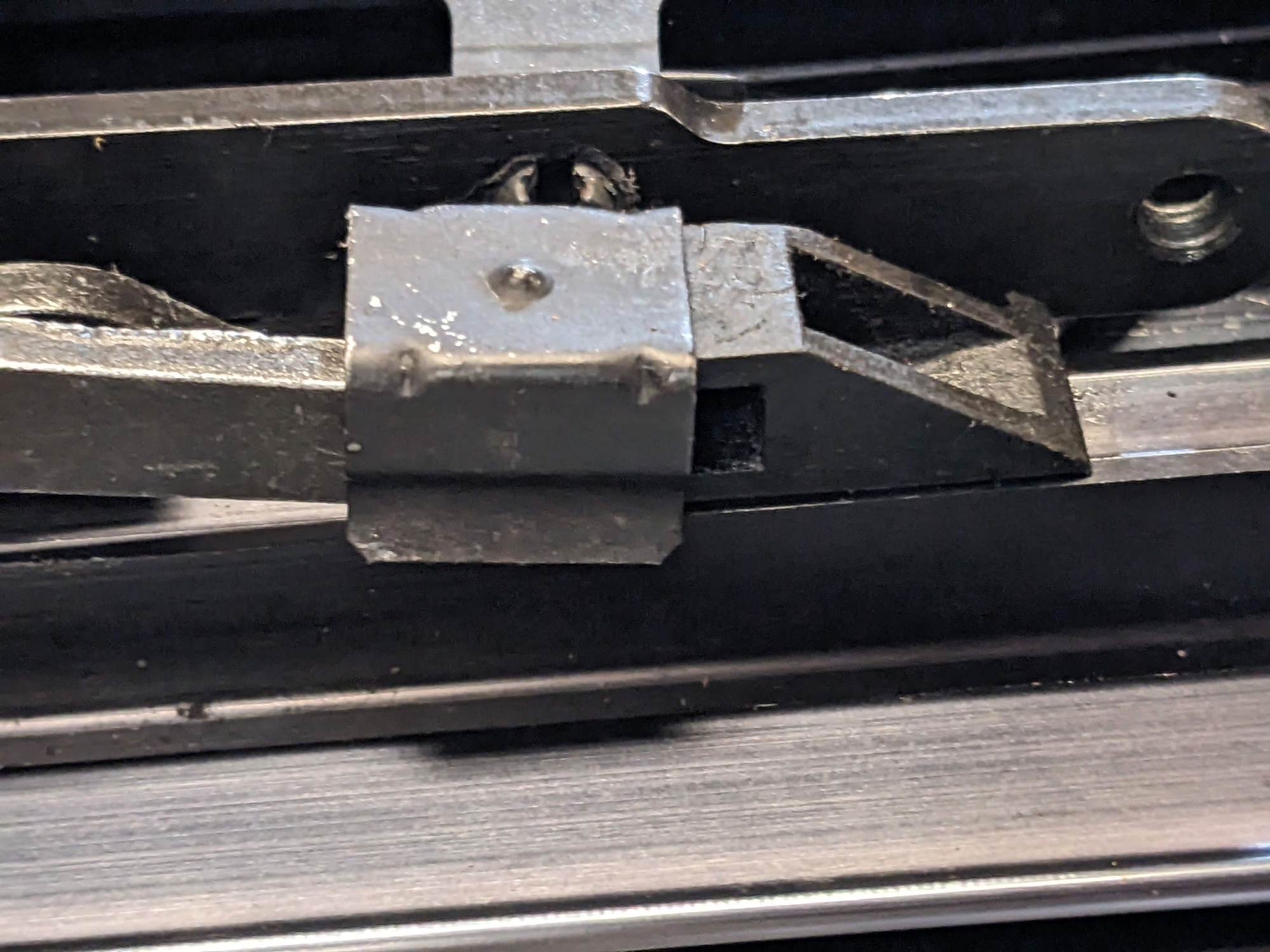

Originally Posted by panchostatus
what about the clips that support the upholstered panel and slide when the roof is retracted?
Do you mean the two metal clips like this?

G’day Oliver,
I’ve never seen any sort of retaining clip in that location, the only place I’ve seen those clips is on the rearward edge, at each side, of the small piece of moveable trim (Drain channel) that moves rearwards as the sunroof opens.

Hi Jeff,
or do you mean this one: Making my own sliding roof parts #2 - Page 2 - Jaguar Forums - Jaguar Enthusiasts Forum
