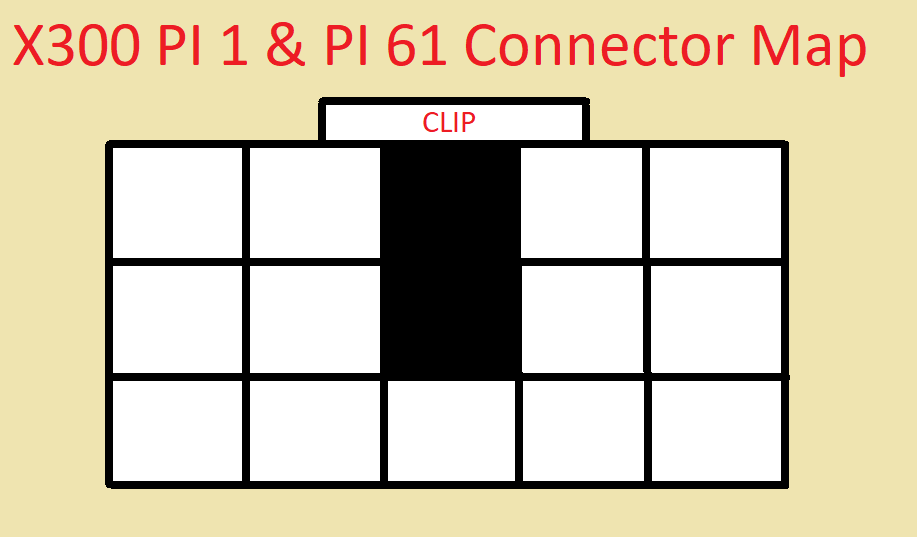

Inspect the Papa Indy 61 connector that has some engine regulation wires in it and the 1 power wire for the heaters , No O2 sensor returns come through this
The 2 Papa Indy 1 and Papa Indy 61 connectors are subjuct of a TSB on corrosion
Heater wire color is White / Green in postion 12
