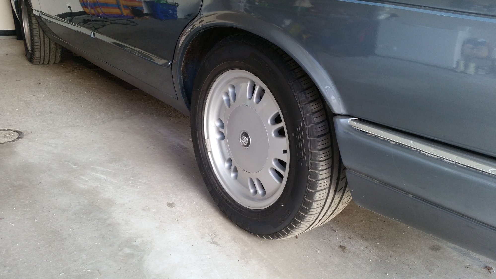

I need help. My 1995 4.0 with 84000 miles had an issue recently with the a frame bushings. It felt lose in the rear almost like it was drifting. I replaced the bushings with powerflex and it seemed to improve the issue. However, I only drove the car a few miles and the next day I took off the winter tires and put on the summer wheels. They are standard size pirelli p7 but I have never driven the car with them before. They are old but with lots of rubber left so I thought they'd be fine. They don't have any mark for direction though so Im not sure if they are fitted correctly. Anyway, after fitting these the car is awful to drive. It suddenly pulls to both sides and I have to correct it all the time. It feels dangerous to drive.
I'm sure the wheels are more than 5 years old but they look almost unused so it's a shame to throw them away. I guess my question is where to start?
Should I try to keep the wheels but take it to a garage to adjust the alignment or simply buy new tires? I'd prefer not having to do both. . I've already spent around 3500 usd on parts since I purchased the car last year. 🤔

Are you sure the P7 have the same pattern and wear on both sides, especially on the front wheels? If they are the same, then to rule out the possibility of the tires, or verify if this was caused by the powerflex, try putting the winter tires back and and see if the problem persists.

The tyres are not directional it seems and I have the same pattern on both sides. Driving on the highway seems perfectly fine though. It's these b roads here in Norway that's causing the problem. Winter tyres with studs have really carved a path it the tarmac, making it pull easily. But my daily drive has no issues and it really became worse after I fitted these old pirelli tyres. I will give them a few more days and maybe lower the pressure a bit and see if they get any better. Maybe also letting out "old air" and inflating them again could help. I guess they have been stored for maybe too long. If I don't get any improvements within a week I'll try changing back to winter tyres. And then maybe purchasing new tyres.. Continental I guess. Or bridgestone.. do they even make p7 any longer?

The age of the rubber could well be your problem: there should be a marking on the sidewall with 4 digits. The latter two are the year the tyre was manufactured, the first two the week of manufacture. All tyres harden over time ( pirellis seem to have a particular tendency to do this) and the process can be exacerbated by the storage conditions . Storage in sunlight for example accelerates it.

I checked the pressure this morning. 2.4bar at the front tyres and 2.7 and 2.5 at the rear. Let out about 70% of the "old air" and adjusted the pressure to 2.1 bar at front and 2.2 at the rear. Drove it for an hour afterwards and it seemed to change the handling a lot. It didn't pull nearly as much and the tyres felt more in contact with the tarmac. There is still a certain vagueness to the steering though, as it does "float" a bit while driving but that has always been there and I fear it might have something to do with either the steering column or some old bushings or other parts in the front suspension. Maybe I will just have someone look at the alignment anyway, but if so, I guess I should change some suspension parts as well before doing the alignment. Maybe s complete front suspension kit from Britishparts would be the solution.🤔💸💸💸

whoopsie... They were from 2009... But now, as I read more about the steering column I fear I might have some slack. Or maybe not. Maybe its just a classic case of googling harmless stuff like a headache and a few minutes later you actually believe you only have minutes left to live

I rotated the tyres and no improvement. I thought I could get used to this but it was a horror to drive so I finally decided to put on the winter tyres again. And what a transformation it was. I would say it felt 80% better. Almost no tramlining any more so I guess the old tyres were the cause. I however still have a vague feel at the steering wheel so I ordered this rack repair kit to see if it helps with the steering issue. XJR XJ40 X300 Jaguar OE Steering Rack bush Repair Kit spc1059 | eBay
