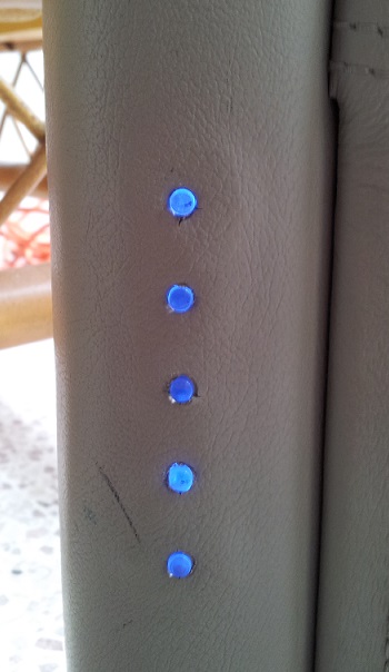

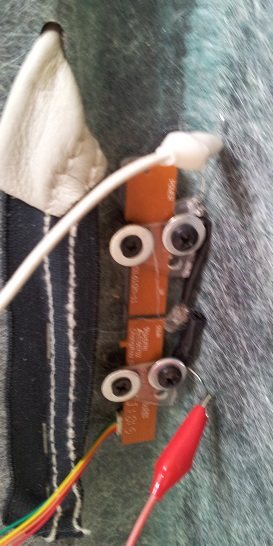

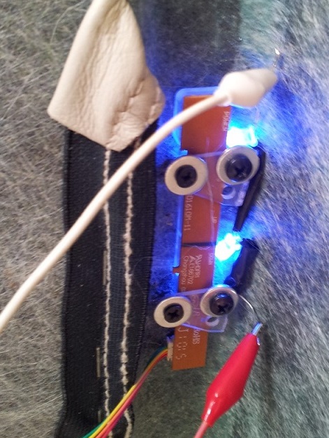

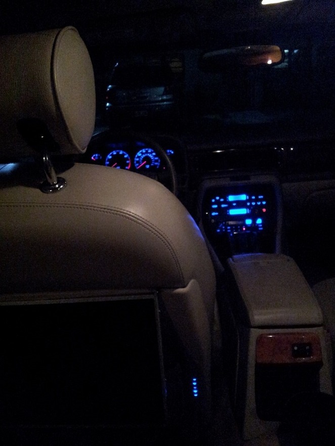

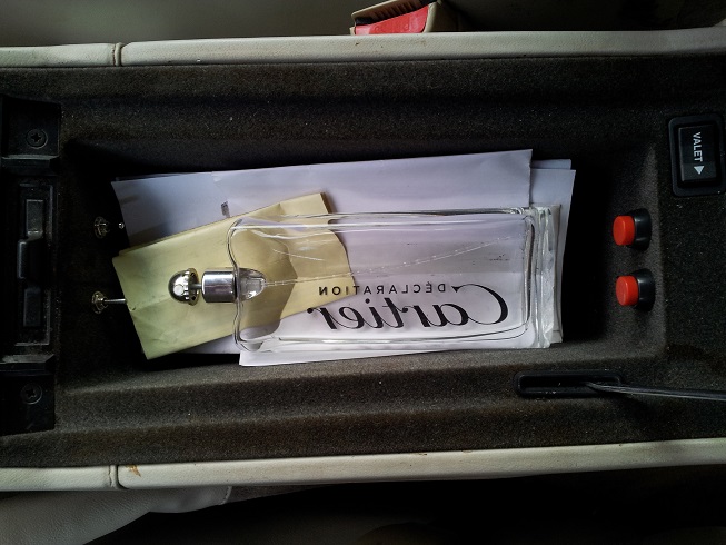

just want to share with you guys the plan of having an incar entertainment system, i am installing a computer with 2 16" led screens behind the front seats and not sure yet what touchscreen ill install in the front or where.(ideas apreciated). anyways here it is... ive started with mounting the rear monitors and did the hack to the cd changer to have an aux input. I did 2 aux inputs while keeping the cd changer aswell. and mounted the switches for selecting inputs inside the center console. the pc will be plugged to one of those aux inputs and the other is for my phone. ive already installed one screen with its controls and now am working on the other screen. they are led screens and work altho where for 110v the dc converter was for 12v so they work perfect on a car without modifications.
installing the monitor controls on the seat
this is whats going on behind the scenes installed 2 leds to each side to have them illuminate the same as the dash and center console.
Attached Thumbnails carputer project-42sh.jpg   carputer project-ncvp.jpg   carputer project-ebnt.jpg   carputer project-4s7o.jpg   carputer project-vl8d.jpg

switches and buttons...
front switches are the aux audio selectors and the red push on/off is one for main power of monitors and other for PC on/off.

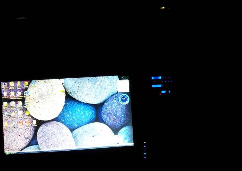

night shot one side still missing the vinyl cover.

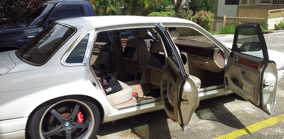

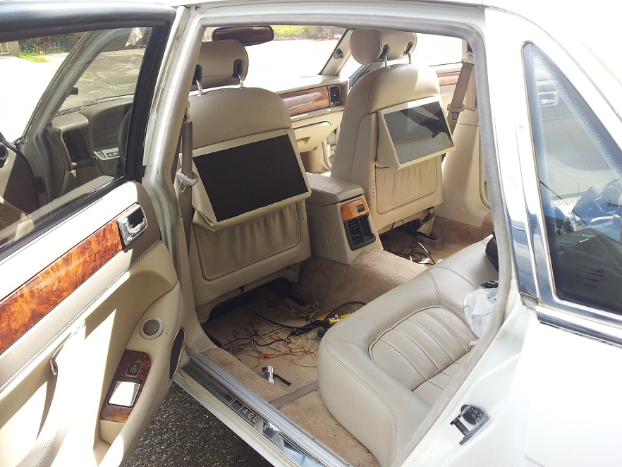

little update finally had the time to finish the first seat, I couldnt exactly match the leather color but i think its ok. im having a problem with vga split signal, i tryd making a vga splitter but all it does is flash the second screen intermittently. here is some pics. the vinyl is saggy on purpose because the screens swivel so that they can be adjusted acording to the seats positions, they can rest flat against the back of the seat or at the other most position is how it looks on the first picture.
Attached Thumbnails carputer project-0vbx.jpg   carputer project-28h5.jpg   carputer project-yaxi.jpg
