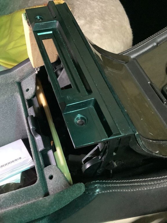

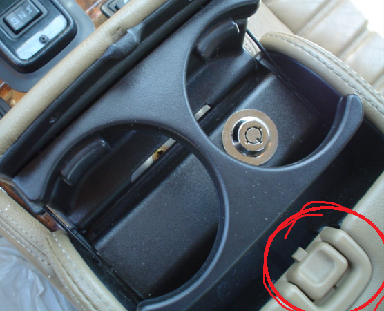

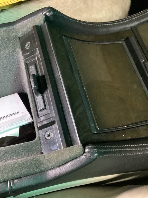

John Herbert's Avatar
Posts: 232
Likes: 240
From: Peregian Springs Qld 4573
Yes, closure of the console lid can be tricky if the latch catch part is now orientated correctly.
I have attached a couple of pictures which should assist.
John Herbert
