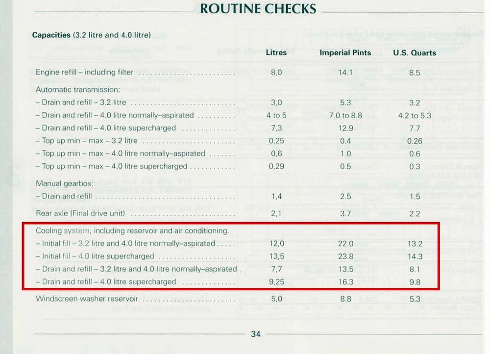

From the X300 Vehicle Care Handbook:

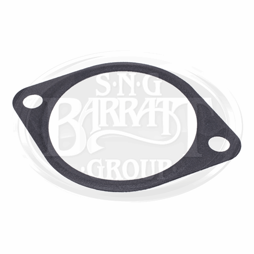

The X300 thermostat is supposed to have a conventional die cut gasket:
The part number is NBB2217AC (photo courtesy of SNG Barratt):
I think the last one I installed was just conventional paper and I gave each side a light coating of Permatex Spray-A-Gasket. Reinzosil or Permatex Ultra-Black or Ultra-Grey would probably work fine in place of the paper gasket, but can create more difficult clean up the next time you have to do the job, and if you drive cars as long as I do, there will be a next time.
