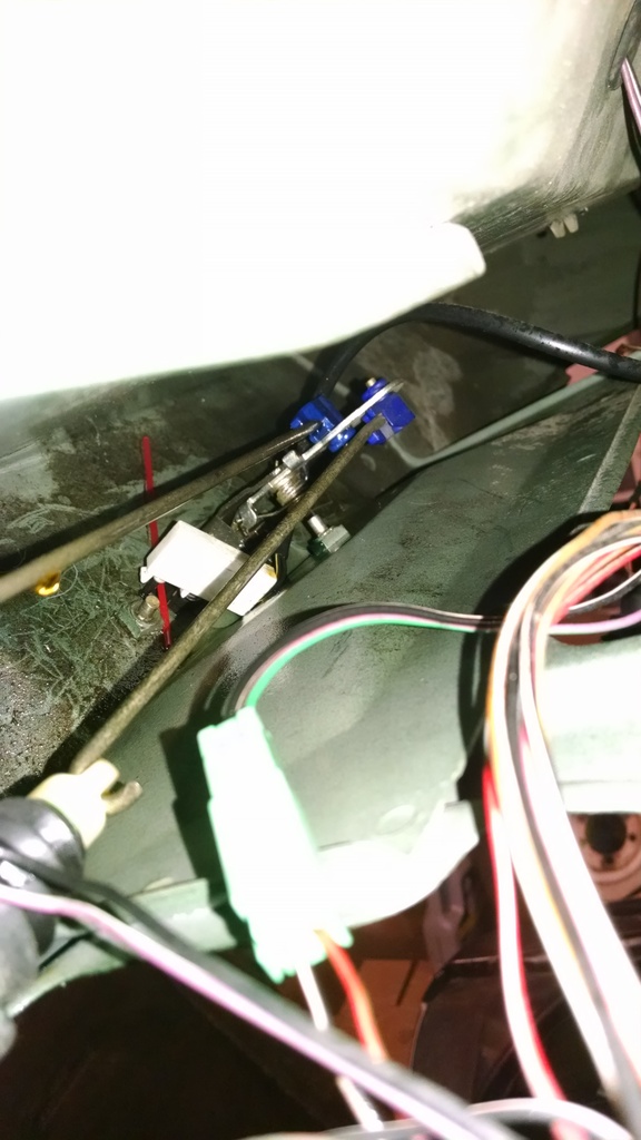

Good luck with that: I fished nearly 2 hours with a hooked rod and only succeeded in knocking the boot-open sensor loose. I sprayed in the lock and all up in those 2 holes liberally with PB Blaster 10 minutes later, it popped open with the key! Make sure you are not using the green valet key.
You are trying to pull this to the left of the picture/right of the car. (view is looking aft)
Here's a view looking to the latch from the key side:

Thanks for the photos - very helpful so I can figure out what's left / right / up / down, when I attempt to fish through the license plate holes to snag the lever

Took the license plate off and the 2 lower "slotted" holes were covered up with a heavy tape material. Exposed the slots with razor blade, then using a rod with a 90 degree bend at one end, fished around for the latch (went in through left hole), found something solid, then pushed firmly to the right... clunk !.
It took less than two minutes to open it.
