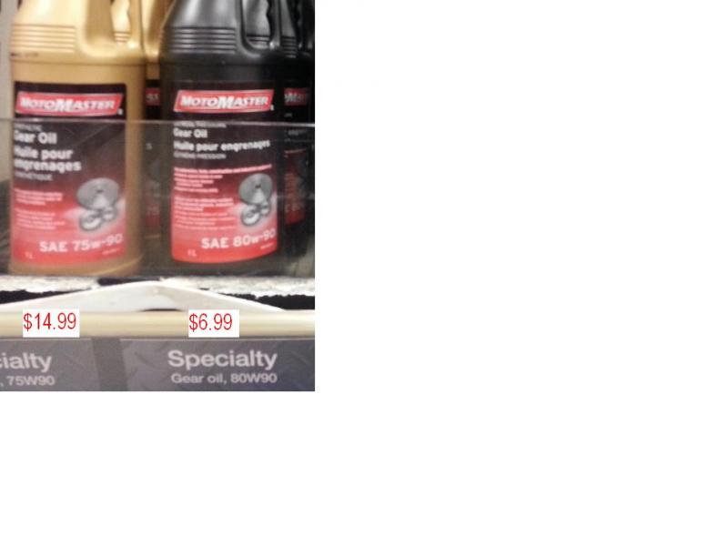

Originally Posted by caldercay
Refill - Spec: API GL5; SAE Visc: EP 90; Comments: Use only Shell Spirax Super 90.
Judging by Pan84's choice of differential oil for this write up, I guess I'm safe in assuming that using the black bottle pictured below is OK to use.
I choose the 80w90 over the 75w90 not because of the price difference (the 75w90 is synthetic) but because I'm not sure if the leak will persist after I clean the breather and refill which will likely be in the next day or two. (SEE this thread - https://www.jaguarforums.com/forum/x...ff-leak-57680/)
Should be fine, right?
Thanks to those able to reply, and to Pan84 for the write-up.

I'm using the 80W90 now. When I resolve my diff leak I'll probably switch to the synthetic.
