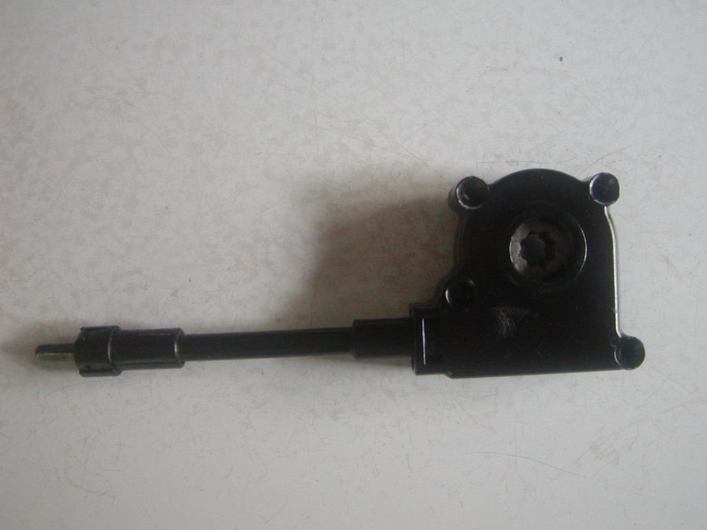

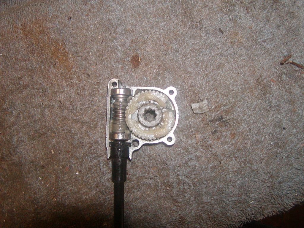

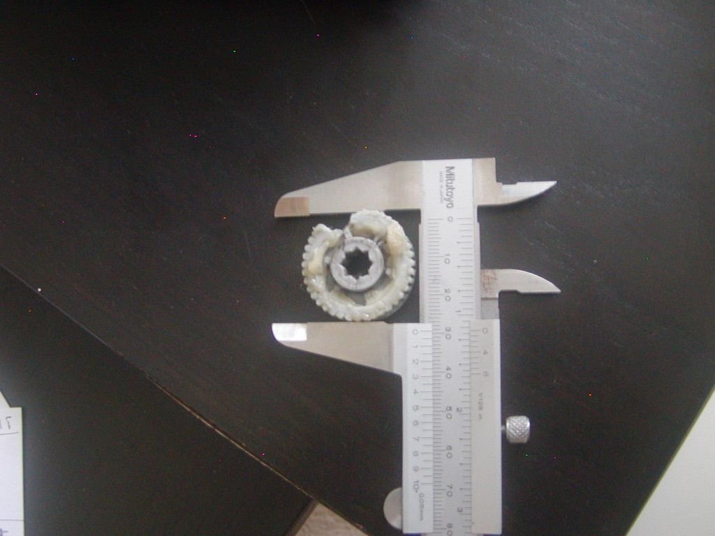

I managed to disassemble the seat and remove the offending rail.
This required the removal of all wiring (that which I could)
Then I drilled out the two pop rivets holding the rail to the subframe.
Took the drive unit apart and found the drive wheel has broken up.
Now to find a replacement!

Yes, I found a solution.
The drive gear wheel had broken up.
I purchased a second hand seat base (cost GBP17) and sent this to my brother in the UK.
He kindly removed the gear box by drilling out the two rivets holding the seat rail to the seat base.
This permits the removal of the rail and the gear drive. He sent same to me.
Awaiting receipt and hoping this works.
Sending the seat base to South Africa from UK was deemed 'Too expensive' thus the dismantling.
