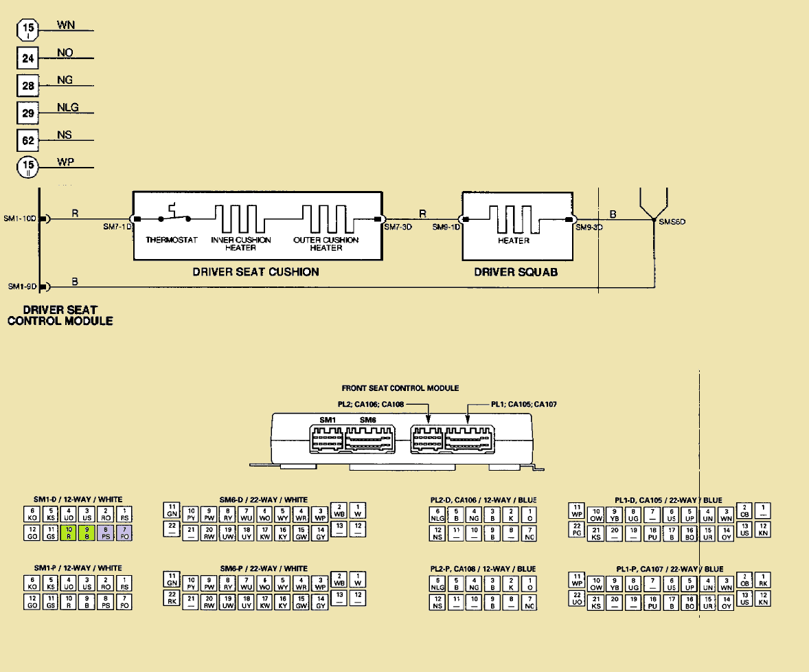

With the suspect motor only going one way that would point to the polarity switching relay inside the module as I believe the potentiometers are used in the memory function and maybe as a electrical stop vs. a hard mechanical stop . Might be able to drive the suspect motor with a fresh 9 volt battery ( ? ) or a battery charger . SM1 - 7D ( Purple / Orange wire ) to SM1 - 8D ( Purple / Slate wire ) for the module connector . Pins marked in purple on pic below :
Can you look under the seat and see if you have a set of relays facing you or a modual that may be able to swap as there are different versions of seats with different wiring
