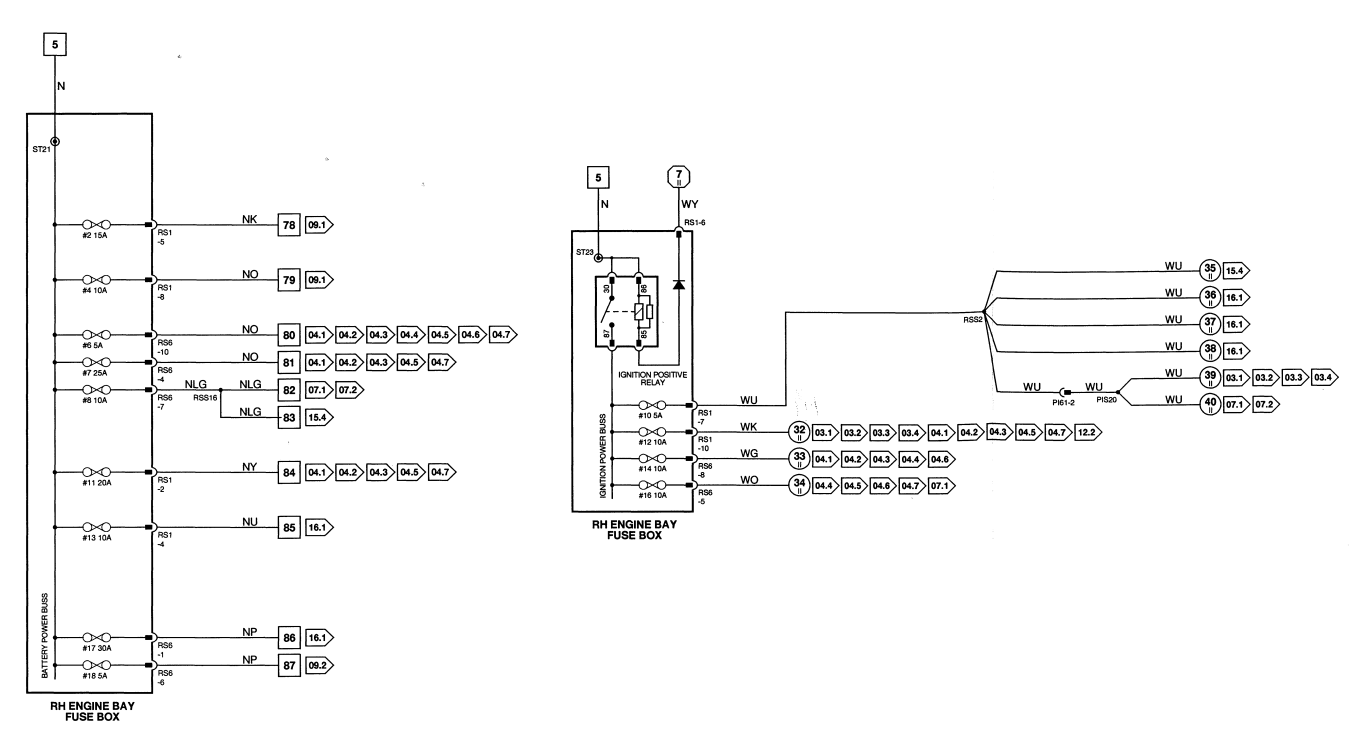

my question is this.
I was going to wire it into a spare fuse slot on my RH engine bay fuse box.
so i will connect the power lead to a spare fuse socket connected to the power bus.
and i will connect the acc/ign lead to a spare fuse socket connected to the IGN switched bus.
so i was wondering does anyone know which empty fuses are connected to which bus?
i am not sure if any empty fuses are connected to ignition bus by defualt and i may need to adjust the wiring at the fuse box.
yes i know i can manually test the fuse box but i thought someone might know.
yes i also know i could just splice the acc/ign wire into an already connected circuit as it only takes a signal and not power but i would like to keep stuff i add on its own circuits.
and could then use this same circuit for any other IGN switched loads.
i feel IGN switch is more appropriate for a dash cam parking mode rather than ACC.
also easier to connect to ign bus as acc bus is all the way in the boot.

on all 5 fuse boxes the fuse # 1 - # 9 are hot at all times bypassing inside the fuse box the king relay in the corner , called the ignition positive relay in the right engine bay fuse box
only the fuse 10 , 12 , 14 , 16 relie on the relay to close
so this leaves fuse 11 , 13 , 15 to be hot at all times , which leaves 17 and 18 unknown
there is 2 ribbon connectors on the bottom side and attached to the fuse boxes
since the ignition positive relay is closed by the ignition switch providing a ground path a cleaner installation would be to have a ground seeking relay ( closing control; half of the relay ) under the dash

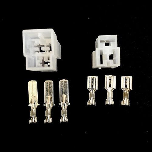

Easy button is to use the existing accessory power sockets. They are Faston 250 series 3-way connectors in the trunk and (in LHD cars, not sure about RHD) driver kick panel supplying unswitched power, switched, and ground. I use the rear one for my battery maintainer and the front for a dashcam with parking mode. This may not do exactly what you want at each specific key position but is existing, fused, switched wiring.

Red arrow points to the accessory socket to which I have attached my battery maintainer's pigtail. The front one on my LHD car, as I mentioned, is behind the driver kick panel (between the dead pedal and door aperture).
A complete Faston 3-way connector kit looks like this. I think the car side has the plug on the left with the straight spades, so if you don't buy a complete kit, you want the right.
