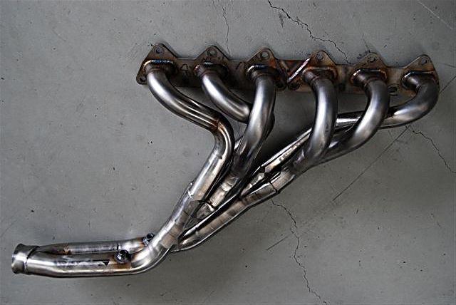

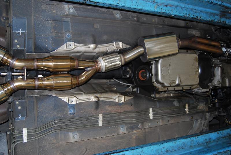

mufflers are critical on the I6 S/C cars as are the v8,s I have no experience with the V8 cars but have done a full headers to tailpipe on my I6 XJR got sick of fixing cracked headers
with the wrong mufflers it will get a bad drone if its a I6 car I talk from experience if I was doing it all over again and knowing what I know now i would install a set of these I know a few guys that have used them now and the sound is great and no droning at low throttle openings

The whole system cost a packet

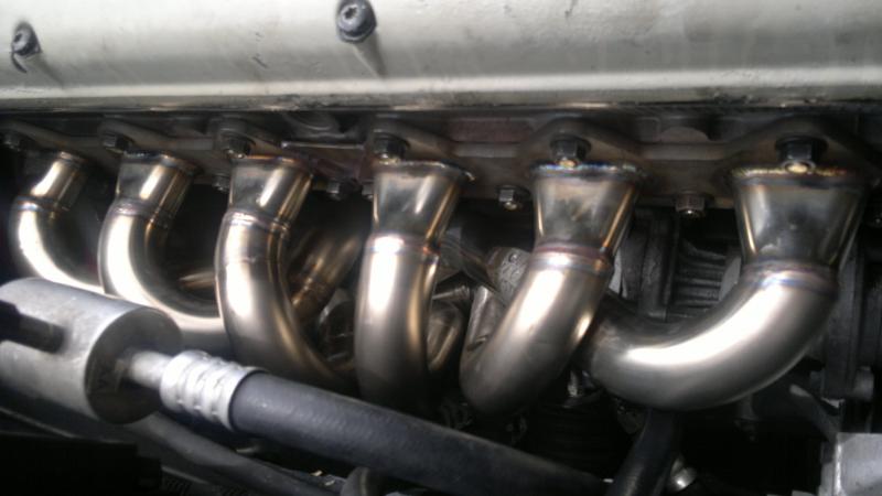

I also have headers made of 304 stainless for I6 X300 for sale direct fit onto the original olive using the front single system
If I was doing the system again I wouldn't use 2 cats that is overkill I would use a single High flow metal substrate cat same as I already use but just one I would then use a single input muffler like this Dynomax® Performance Exhaust | Mufflers | Dynomax VT™ Muffler then splitting it into 2 mufflers at the back that way the cost is reasonable and with the VT muffler you get the best of both worlds no drone and great sound when you are on the gas

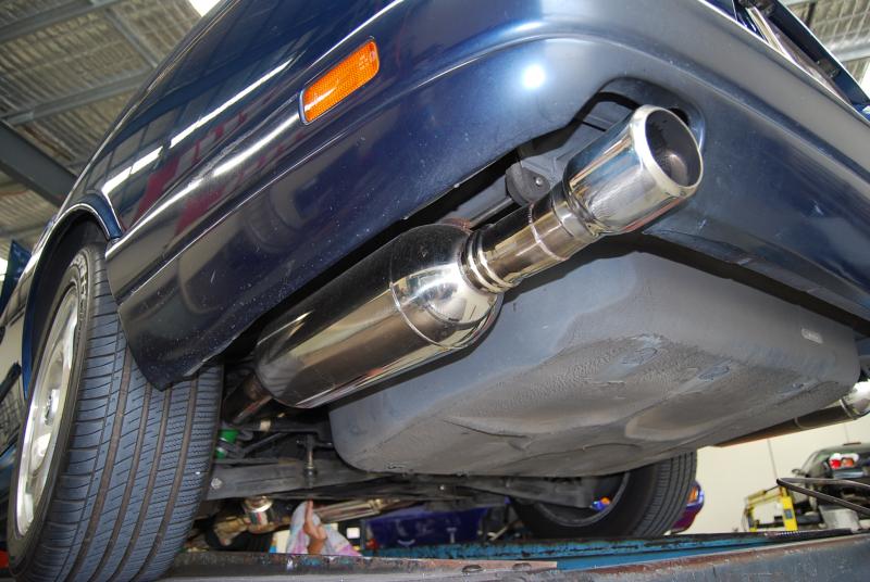

My car sounds fantastic I have since designing the headers and system redesigned the rear mufflers the I 6 engines drone quite a bit when the pipes are big my system is 3 inch out of the headers slimline resonator splitting into a twin 2.5 inch system a bit big that's why I changed the rear mufflers
Basically I would use the headers I build using the original underfloor pipe get rid of the twin underfloor cats using a single high flow cat then the VT muffler and a set of cherry bombs or as we call them here in Australia a Hot dog muffler that way the original piping could be used to save money
