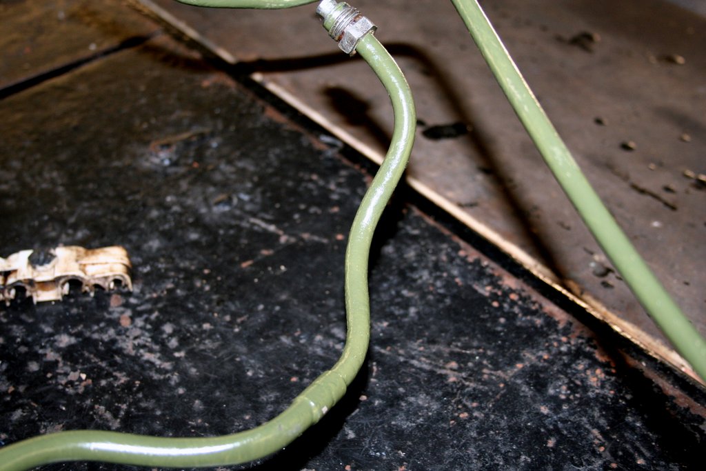

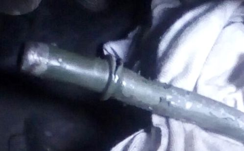

I have faced new issues trying to rescue Rose. The new injectors have been fitted and engine now starts fine. However, the fuel pipes under the fuel tank are causing problems. I already sourced a new fuel feed pipe (the high pressure one) a while ago, but the other one, the return fuel pipe was found to be broken at the tip knot, so fuel was leaking from the tank. Thought that there would be many used parts lying around but the common feedback is these pipes are usually badly rusted and are therefore normally trashed after breaking the car. The use one (see picture) I got from eBay was a rare find, but it was no good because the male connector part of the pipe (called the quick-fit design) is tilted and the lower part of the pipe was bent at various curves. Obviously it was brutally removed from the fuel tank by force rather than following Jaguar's advice of using special release tool made by Huron.
The two quick-fit female connectors on the fuel tank bottom; one for the feed line, the other return line:
The broken male connector
A used male connector - unfortunately no good as it has a tilted tip
The trouble is that although new part (NNA6102AG) is available overseas (the local dealer and parts suppliers do not keep them in stock) it is not only expensive (around GBP150), but it is also a one long piece running from boot bottom to the front engine. Shipping alone is more than 5 times the cost of the part. Why Jaguar wanted to make the return pipe such a long piece is difficult to understand. I believe that if I can find a fuel hose connector of the right size and design, I can use rubber fuel hose to connect to the rest of the pipe that runs to the car front. The return fuel pipe is 9.5mm in diameter. I found some universal fuel hose connectors on the web, and wonder if folks have any experience tackling the same issues and what would be the best way to go.

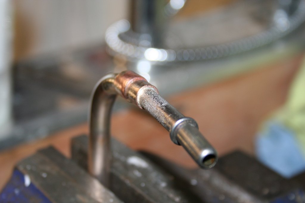

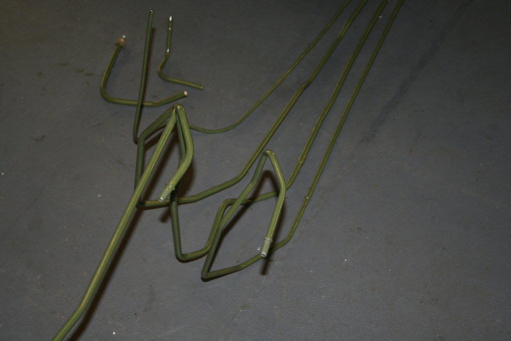

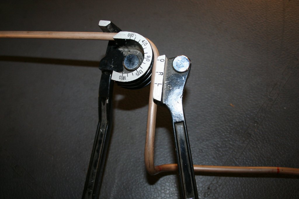

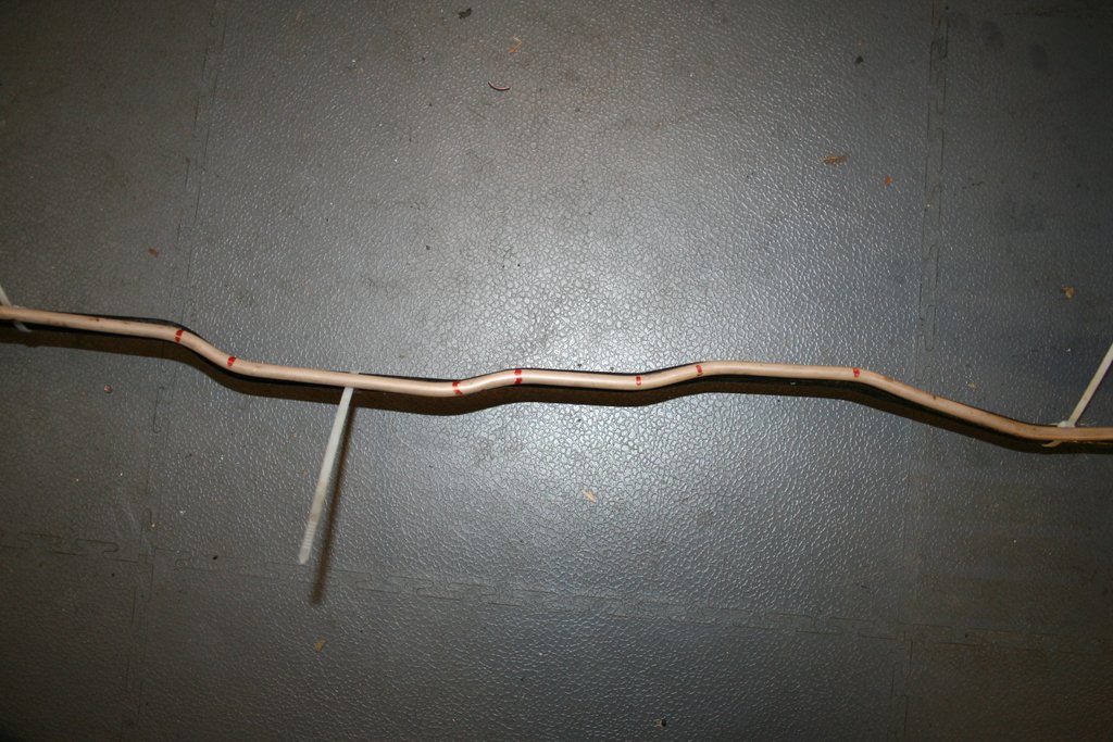

When I rebuilt my car some years ago the fuel pipes were very rusty. I had similar issues with new parts. They were very expensive and were on back order with no expected availability date.
I decided to make my own. I was not able to find the correct quick fit ends as a separate part and as the ends on the old pipes were not in a terminal state I cut them off reused them.
I made all of the new pipework from Kunifer tube. I used the old pipes as a pattern and using a cheap mini pipe bender managed to make something pretty close to the original shape. All joints, including attaching the old fittings, were made by brazing a straight copper connector - same as used for plumbing.
Copper may not be the best choice (galvanic corrosion?) but was all I could find at the time. The car has been back on the road since 2012 so pipes are holding up OK.
For the flexi parts I used standard rubber fuel hose. I put a slight flare on the end on the Kunifer pipe where it was being inserted in to the rubber hose and used standard fuel hose clips doubled up. Again no issues since 2012.
Hope this gives you some ideas. I've attached a few pics to help also.
