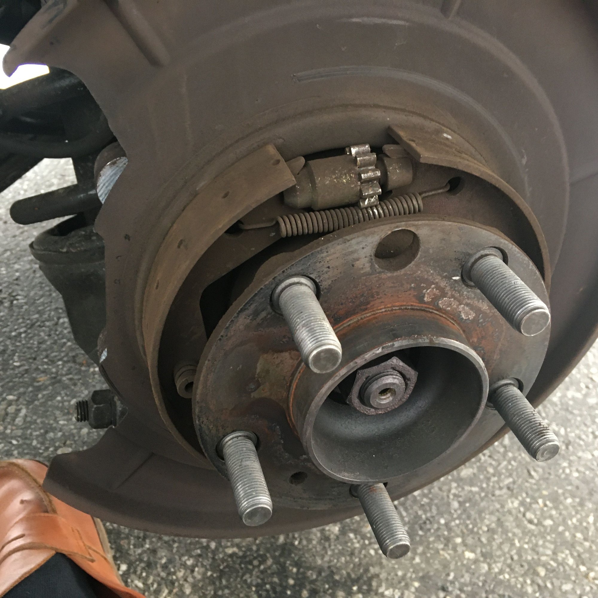

The adjustment for the handbrake shoes is achieved through a hole in the brake disc, which will be visible with the wheel removed. It is near where the wheel studs come through the brake disc. You need to rotate the disc so that the hole is around the 12 oclock position, and then by shining a torch through the hole, locate the adjuster mechanism, which is a screw with a toothed head on it which sits horizontally running right to left. The teeth on the head allow it to be turned with a flat bladed screwdriver, altering the distance between the two brake shoes and achieving the required adjustment. Sounds simple, but very fiddly. In reality, the problem is often that the mechanism which converts the handbrake cables pulling action into a spreading action between the handbrake shoes, located at the bottom of the brake shoes, becomes stuck, with the result that most of the effort you apply with the handbrake goes into stretching the cable. Responds well to disassembly, cleaning and lubricating, but again, very fiddly.
I would be inclined to try to sort out the light first, in case something has gone awry at that end of the mechanism, as it will likely be more easily fixed.
Unless you are in the habit of using the handbrake to stop the car, there should be little if any wear on the shoes, although if you are not in the habit of using the handbrake, the general state of dust and dirt inside the brake disc may persuade you to change them. They are not expensive, but fiddly. Did I just say fiddly again?! Although I place my faith in Park, I always use my handbrake too, so that I don't have to do this job again for a long time

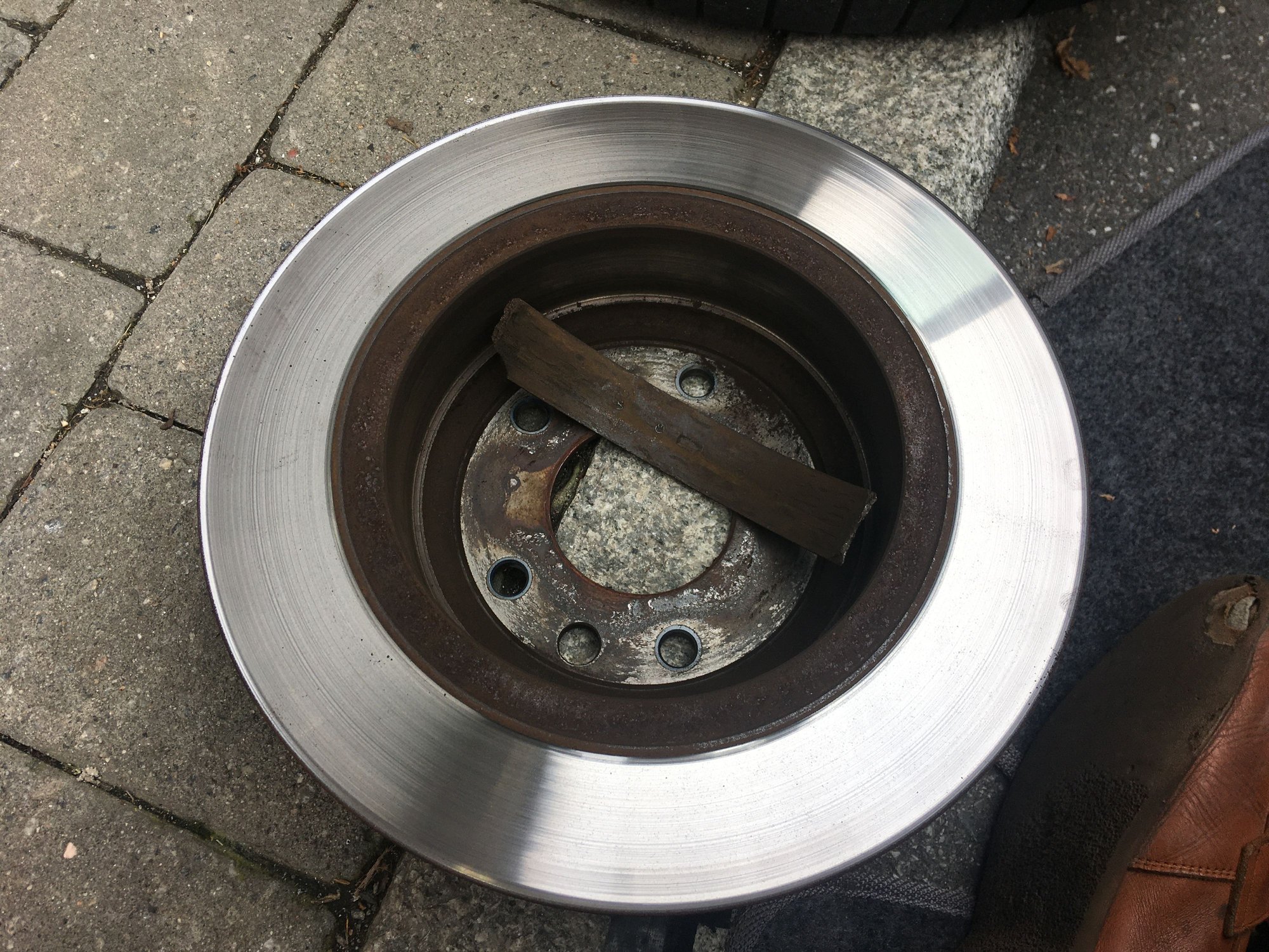

i would advice pulling the disc off to check the brake liners just in case if they are of unknown age - mine had delaminated!
