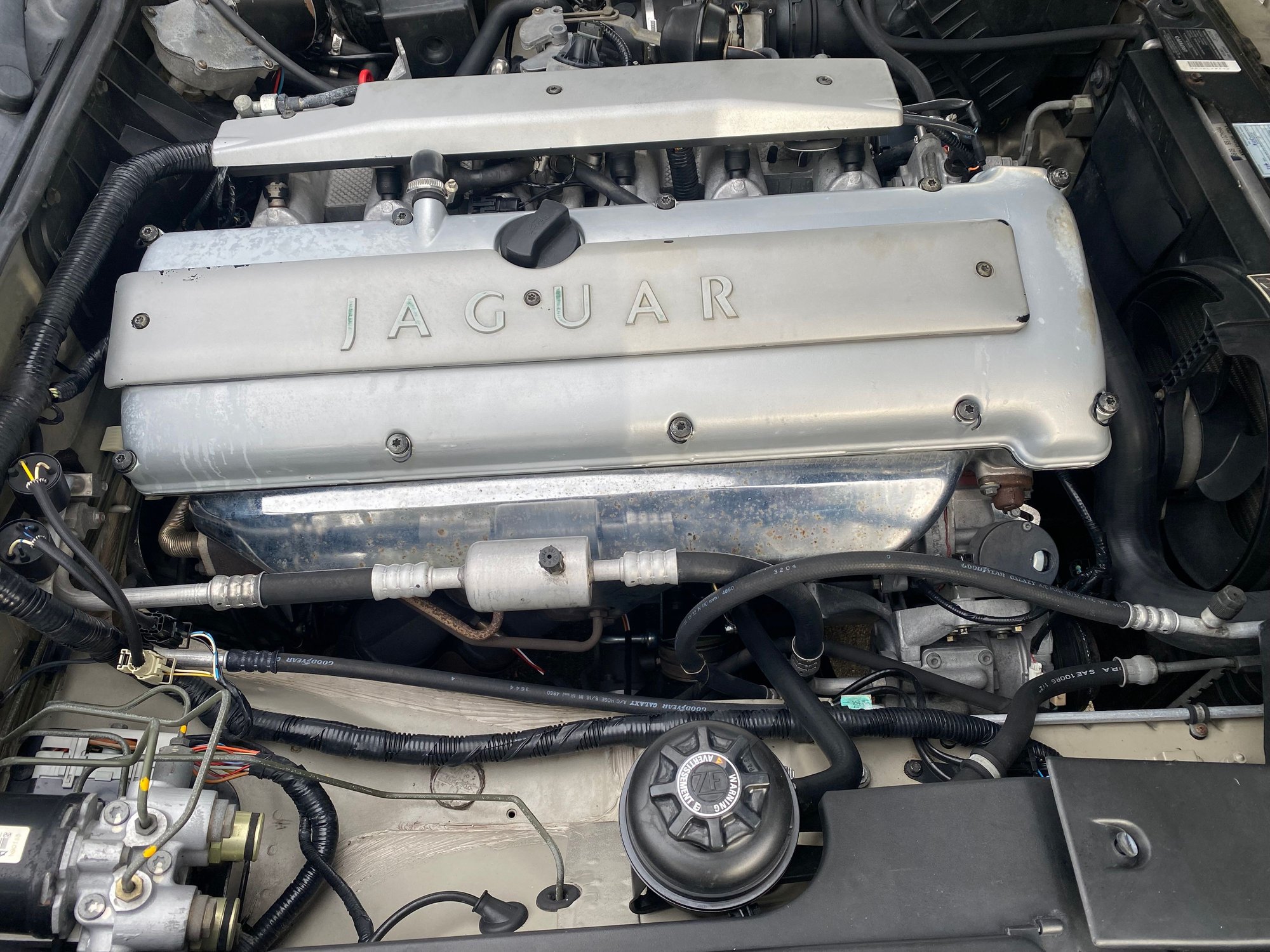

It also has an expensive high resolution sound system installed. Feels good to have it back. Glad I didn't give up on it! Here's some photos from today:

Nice car, very clean engine bay, just a small observation -
Is your cam cover oil cap on correctly ?
The wings usually run North/South in line with the cover, yours are at an angle.
John Herbert
(1996 XJR)
The cam cover is not original. I bought a used one and had it blasted and powder coated.
I used my original oil cap.

To further clarify my observation, I believe it may be your oil cap that is not original, all cam covers would be the same, I am not aware of any variation in the oil cap cut out on the cam cover.
See pictures attached of X300 cam cover with no cap and picture of cap fitted, your cap apparently when closed is at odds with the norm.
I also attach photo of original oil cap for X300, note the difference to your cap.
