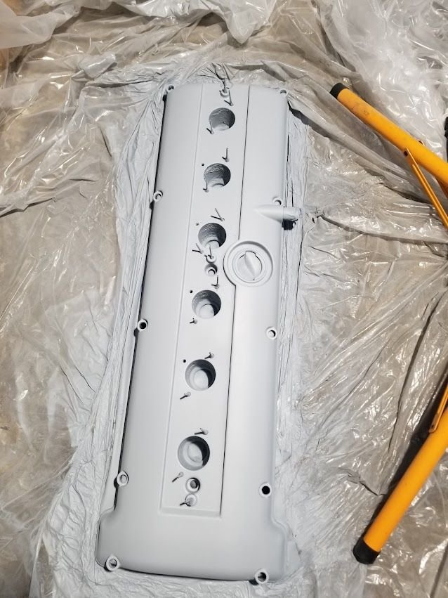

There's a good chance that the spark plug holes in the cam cover have some corrosion. When I did mine about 20,000 miles ago I noticed there paint was lifting right where the seals go.
I sanded mine down and put some high temp paint on them before installing with the seals. Been dry in there since (2 years)
If you were to go back and do it again, I would suggest replacing the spark plug tube seals again as they may be pitted from the corrosion.
I hope this helps

My xjs 4.0 spark wells were corroded too, i sanded it all down and used the black sealer which is very important to seal the imperfections. You may want to look for a good used cover now and then for a good deal.
I used permatex black
cleaned with dremel and tiny wire brush attachment.
permatexed after
I need to seal permatex a crack in my ignition coils now that i recall lol
When you permatex the imperfect to say the least spark seal housing make sure you leave something heavy on top of them i used glass water cups to weigh them down each.

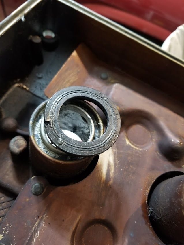

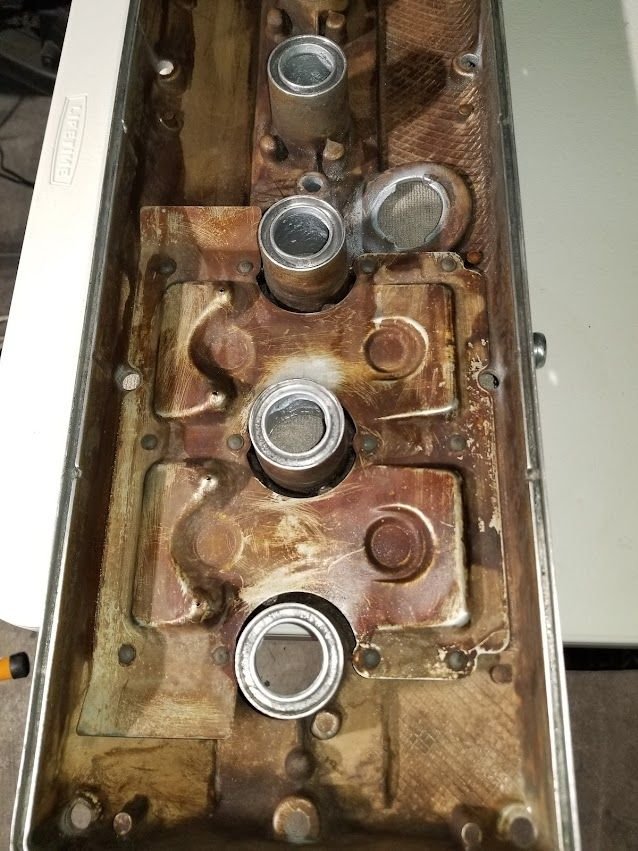

I recently did a really big repair on my cam cover.
guess we will see how long it lasts.
here is a link to my thread so you can maybe have an idea of what could be involved depending on the condition of yours.
https://www.jaguarforums.com/forum/x...-252889/page2/

How's your camcover holding up?
Did you POR15 the inside of the cover too?
Old May 7, 2022 | 07:05 PM
Spud Maat's Avatar
Joined: Oct 2021
Posts: 1,389
Likes: 565
From: Sydney
i did do the inside also.
it is holding up really well so far. No leaking or signs of any damage so far.
It did start to discolour the silver was turning a yellowy tinge, i assume due to heat.
so i gave it a coat of hi-temp alluminium engine enamel.

oops probably google. uploaded manually.
This is the kit
Amazon Amazon
Do the prep and permatex right the first time no need for OEM silicone is silicone.
