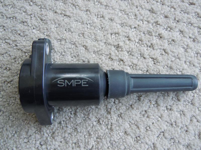

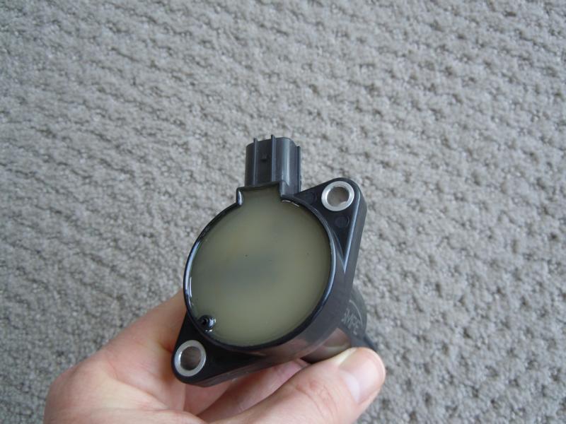

Here are two pics of the coils I received from britishparts.co.uk. Are these the same as the Beck Arnley ones?
I specifically ordered from England, shipped to Canada, hoping to get made in Japan. Oh what a tangled web we weave..... As I mentioned, the ones the Jag mechanic installed looks like the factory ones. So maybe it was still NOS from his Canadian supplier?
Now what do I do?

They don't look like the Beck Arnley coils I've recieved, no. But....Beck Arnley might be getting their coils from who-knows-how-many manufacturers.
BTW, I'm waiting to hear back from the Ebay I recently bought from. He said he'd try to find some Eurospare coils for me.
Now what to do?
If you have urgent need to use the coils you received then do so and hope for the best. Otherwise hold tight and maybe we can find some Eurospare type.
