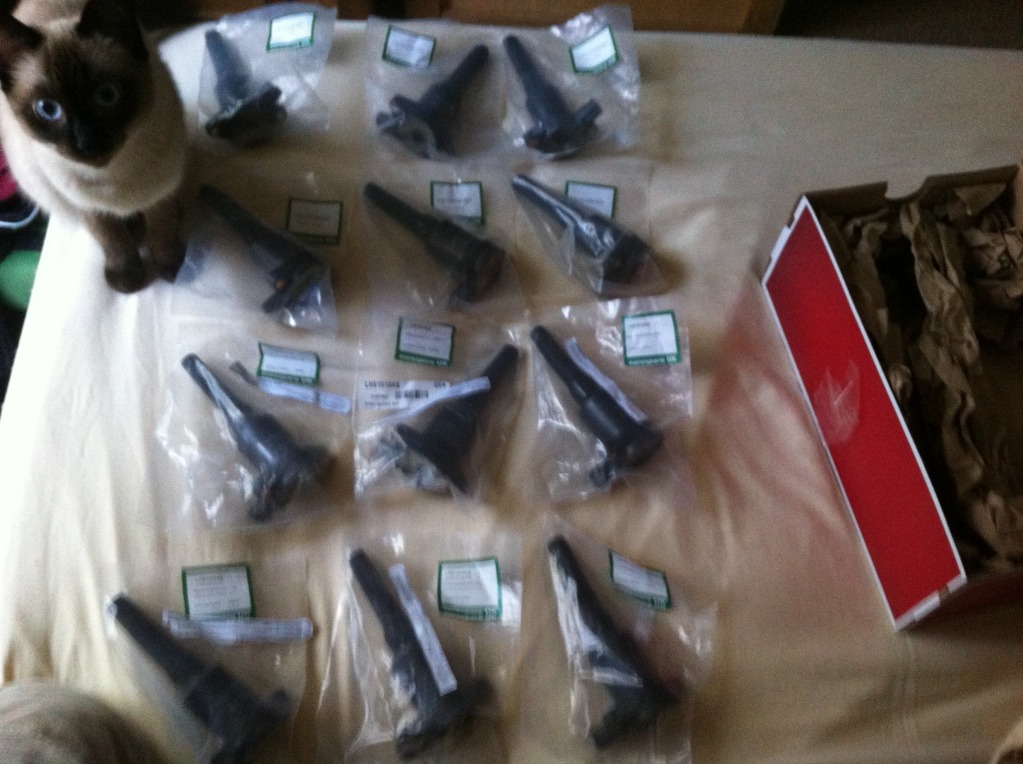

Old May 10, 2013 | 05:08 PM
  #44
Spikepaga's Avatar
Posts: 2,991
Likes: 567
From: Houston, Texas
Got 12 Japanese coils. 6 more and I will be able to sleep at night lol:
