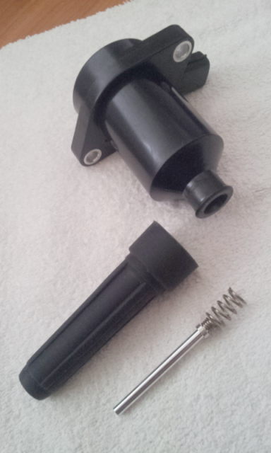

Does the long tube that connects them to the plug screw on? Luckily, I haven't needed to investigate this issue.
Old Feb 3, 2014 | 12:03 PM
  #100
caldercay's Avatar
Joined: Jun 2011
Posts: 307
Likes: 68
From: Cypress, TX
I believe you're referring to the rubber "boot". The coil consists of 3 components:
* Coil
* Insulating rubber boot (not screwed on, simply pushed on)
* Spring connector (inside of the boot)
