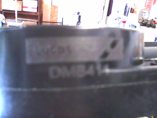

For anyone interested...
Pics #1 and #2 are an actual, original coil.
Note the black label with numbers and "Made in Japan". The Eurospare replacements I got earlier had this same label and matched the apperance of the orginal coils in terms of expoxy used, molding characteristics, etc .
The white Lucas label with the Jaguar part number is also shown. I wouldn't expect to see this on any coil sold via aftermarket channels even if it came from the true OEM manufacturer. It might be present on a coil ordered under the original part number from Jaguar, though.
Pic #3 (low quality, sorry) shows the Lucas identification on a recently purchased coil.....which was 'supposed' to be Eurospare. It says "Lucas DMB411". There are no other markings of any kind.
DD
PS- it's a bit amusing how something can be both "Made in Japan" and "Assembled in the UK" :-). The semantics of manufacturing are interesting

Third and final coil was installed yesterday by my Jag specialist... No box, just a bag with a Lucas part number stamped on it, which he didn't keep. Coil itself is also stamped with Lucas and the part number.
Turns out it came from Worldpac, not the dealership.
Just a words game. They where made in Japan and boxed in the UK.
I managed to find six more the of the "real" OEM Eurospare, Made in Japan coils, I will probably get 6 more if I can.
The new so called "Lucas" coils are made by "Elta Light". This "Elta" is a UK company, but I am still trying to get to the bottom of where these new coils are coming from. It definately could be that somewhere, someone, has figured out how to make these coils with the same or better quality than the original Japanese coils made by Diamond and distributed by what used to be Lucas in the early 90's......but I am not interested in being a guinea pig unless I really have to. We won't really know how well the "new Lucas" coils are until someone has replaced a full set in their cars and used them for several years.

I am also finding that these "new" Lucas coils can be obtained extremely cheap. On this case at "AUTOARTSWAY.COM" they are listed cheaper than the Beck Arnley coils that self implode within a year. I have also found that some but not all eBay sellers have lowered their costs on these "new Lucas" coils. I don't want to pay 400.00 for a new coil, but if a coil is being sold at 60.00 dollars it means that the merchant is buying for 30-40, which in turn means that it's all that much cheaper to produce. I am also speculating that the "real OEM" coils made by Diamond and recently sold thru EUROSPARE for around 115-140 dollars where not very cost effective and this is why in part they are quickly disappearing from the market.
Entirely plausible.
We'll have to see how things play out with these Lucas coils.
I'm contemplating that, if long-lasting brand new coils are not being sold, it might be better to buy up a slew of used, true-OEM originals at $20 each. Although their lifespan would be uncertain it might end up being a better bet. If we're doomed to near-continual coil replacements over the long haul, why spend $45-75-100 each for uncertain life span when the same uncertainty can be bought for $20?
I dunno. Just a thought.
DD
