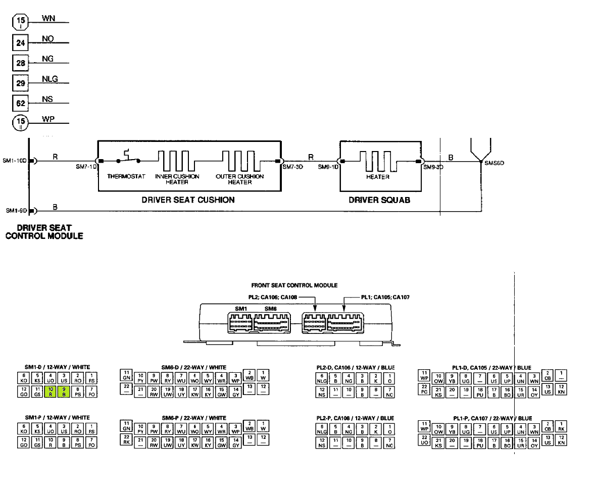

There are 5 fuses involved . Will start with driver seat first because that's my favorite one as a NAS ( North American Standard ) option as there are others .
# 6 / 5 amp LH Heelboard Fuse Box
# 3 / 20 amp RH Heelboard Fuse Box
# 4 / 20 amp RH Heelboard Fuse Box
# 9 / 25 amp RH Heelboard Fuse Box
# 12 / 10 amp RH Heelboard Fuse Box
To read the heating element read for resistance at socket 9 ( black wire ) through 10 ( red wire ) of the front seat control module connector SM1 - D located under the seat
You don't want to see a complete open ( high ) or complete close ( 0 ) on the element .

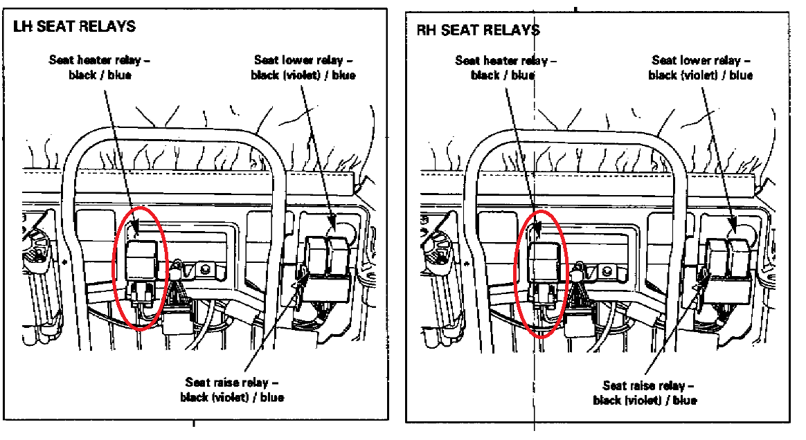

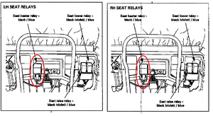

Non Premium seats do not have a seat control module , just 2 fuses and a relay
# 5 / 10 amp Trunk Fuse Box
Relay location under the seat
To read the element you would read resistance from the Orange / Pink wire at the relay to ground . You will be reading through a parallel circuit path for the dash switch light
