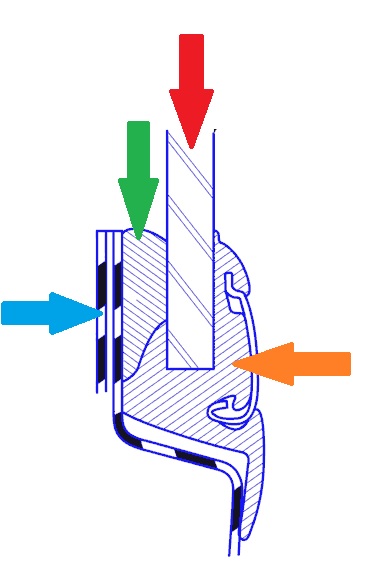

NO - the windscreen glazing rubber only secures the chrome or black finisher. To remove the windscreen you will need an angled hot knife to work between the aperture and the rear of the glass (arrowed green).
After cleaning all the old sealant from the windscreen and the vehicle aperture, you will need a "Betaseal Sealant Kit" to bond the windscreen into the recipient vehicle.
The windscreen (arrowed red) itself is bonded to the vehicle body (arrowed blue). A bead of sealant is run round the perimter of the aperture and the assembled windscreen/glazing rubber/finisher (arrowed orange) pressed into it. The sealant is usually heat cured by passing a current through an embedded wire in it.
I used to run a factory manufacturing vehicle windscreens and also have a reasonable amount of experience in fitting them. However, I wouldn't consider doing a removal/refit job myself as the risk of breakage is extremely high.
