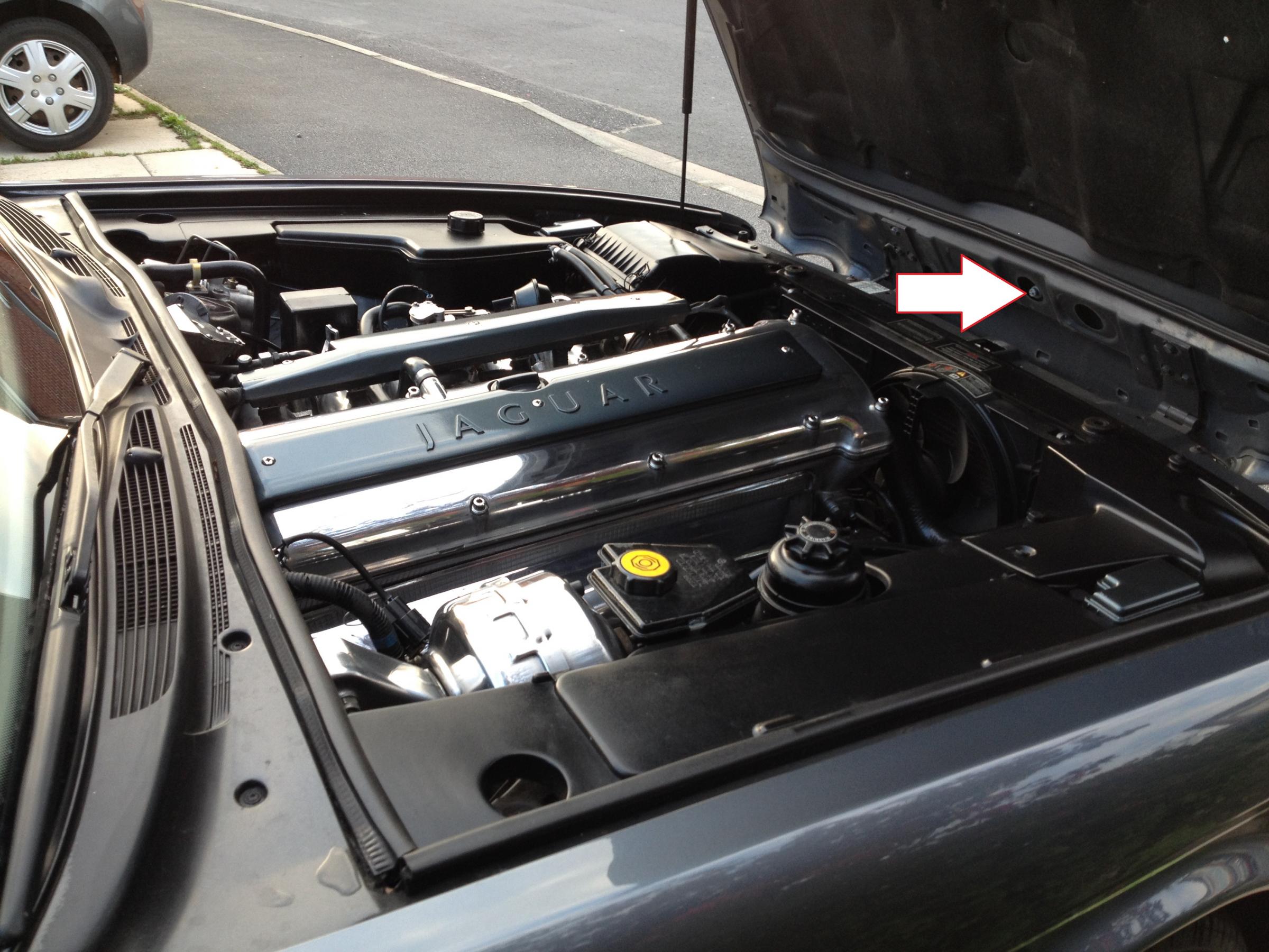

There is a hole for the leaper nut in the centre of the front strut
See attachment I've put a big arrow on where it needs to go, just measure from the centre of this hole to the front of the bonnet and transfer this measurement to the outside (with masking tape) and drill.
You will need a step dril to get the hole big enough.
Now THAT helps me a lot! That will make sure the leaper is mounted in the correct position! Cheers for that mate!
