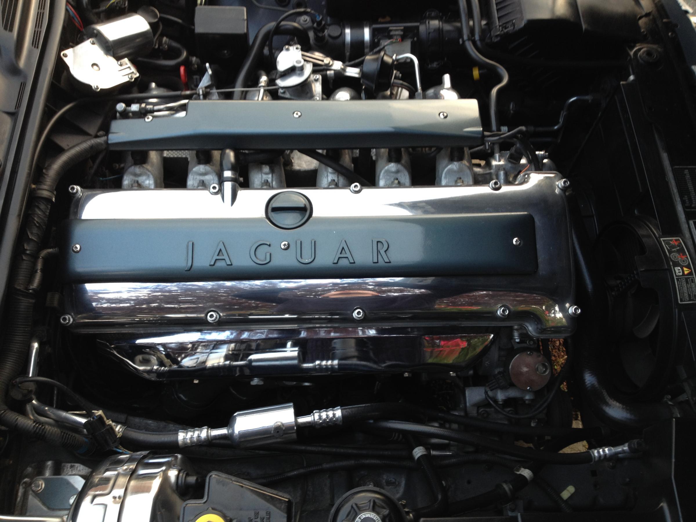

You could always just polish it, like I did with mine...
That IS a neat engine bay!

How did you polish all of the covers like that?

Every metal component was striped of paint and hand polished - mainly in situe apart from the cam cover which I bought a 2nd hand one and polished it separately.
Intake manifold was the worst to do, due to its shape and accessibility.

I love the idea of polishing it. What did you use to get such a strong shine? No issues with the enamel bubbling? It'd be a good bit cheaper to polish it than paint it over having it Hydro graphed. I just want something that will last for the next 300,000 miles and 30 years.
