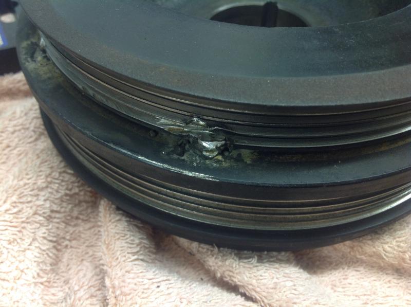

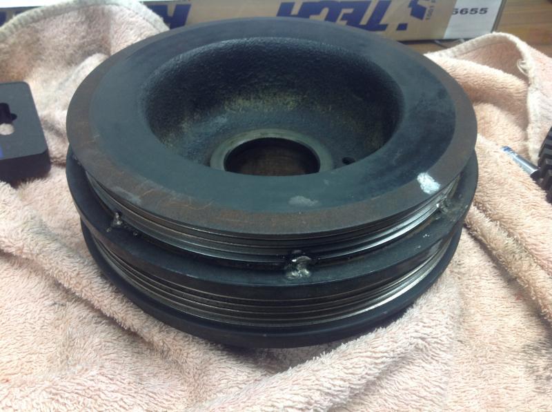

Hey Lads,
Well it comes to this.
These pics show what I have been up against with this XJ since the beginning. The level of craftsmanship just cannot be talked about enough. Gee, I wonder why the pulley was wobbling?
Ok, the car is at the shop and they pulled this out. It is not going to be usable so I need to find one fast. Could someone please save my butt here and sell me a rebuildable unit for a decent price? I would need to have it drop shipped directly to HB Repair but I will provide address and gladly pay the shipping.
I just need to get one fast because the car is now sitting at their shop.
Please let me know asap
Be kind, I have been getting my butt kicked on this one and I am in the 11th hour of putting this fine car back on the road proper.
Bernie
Hmmm. Maybe I'm confused (referring to level of craftsmanship) ... that's not a stock damper as it comes from the factory or a rebuilder ... looks like someone tacked the two halves together as some sort of "fix" to a de-lamed damper?
Might try the Dale at Dale Manufacturing, in Salem, Oregon (hbrepair.com) or Damper Doctor.
Haha,
Yes I did confuse you.
I was referring to the craftsmanship of the previous owner and not Jaguar. Sorry about that.
Ok, I was able to grind off all the welds.
I spent an hour with a dremel, rat-tail files and sandpaper and I have all the serpentine channels looking smooth. Anything that looked knife-edged from the botched job I had to lower a little. I figure the belt will just ride over the one or two low spots.
Its all cleaned up and ready to be shipped off to Dale tomorrow. That's who I have been dealing with all along. He can repair it further he told me if it needs it and will also braze the timing wheel crack. Runs cost of rebuild up some more but not worth mentioning since guys that I spoke to today were wanting two or three hundred dollars for a used one. Funny where the price goes when you are desperate
