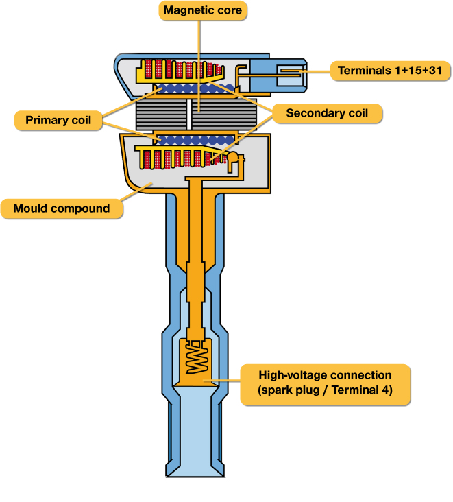

Originally Posted by Satterfield
what goes wrong with an ignation coil ?? anyone cut it open to see ? Satterfield
The "mold" (that stuff that looks like hard wax) starts to break down opening up a path for either the primary, or secondary, coil to start arcing with the magnet which separates them. That high voltage arcing will eventually take out the portion of the coil which was previously unaffected. Generally, if the primary "upper" coil goes first, you'll experience sporadic hiccups before complete coil failure. If the secondary "lower" coil goes first, you'll experience an immediate, consistent miss on the affected cylinder.
Attached Thumbnails ignition coil insides ?-ngk_kerzenschachtspule_querschnitt_en.jpg
