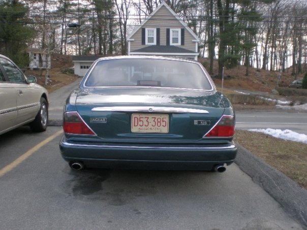

Hey everybody, I have a '95 XJ6 and went into my garage today to refinish the rear fenders since the paint back there was bubbling and the metal rotting. I had ordered some paint from expresspaint by the color code on the inside door jam...HFE...comes up Kingfisher Blue. I always thought my Jag was british racing green or at least close to that color, but I figured maybe the Brits were just whacky and decided to call the color blue. Not the case! The color isn't even close to matching. This leads me to believe the car may have been repainted at some point, but I have seen many other X300s with the same exact color so I'm thinking it must be an OEM color. I'm attaching a few pics of the car for reference and am hoping somebody can point me in the right direction to get this color matched up. Right now I'm driving the car with painters tape all over the rear fenders as I'm embarrassed to let the paint show right now! Thank you

That car is BRG, and I am pretty sure the OEM code is 753.

That's odd sparkenzap...the code on the inside of my door says HFE for Kingfisher blue. The color looks a bit darker in one of the photos than it is in person. Expresspaint told me they found out the can of paint they sent me has a missing toner in it, so they agreed to mix me up another can and send it out free of charge. I'm awaiting it's arrival and will report back afterwards. Thanks for the help to the both of you

That's the correct color. Jaguar calls it Kingfisher Blue. It's more green than blue, but that is the correct color and paint code. The British Racing Green is much more green than that.

well my monitor must be poorly adjusted. That car looks just like mine.

Yes sparkenzap the pictures I provided to make it look darker in color than it really is...it is lighter with a hint of blue but mostly green. Ken is correct and I sent him a PM. In the meantime I'm trying to find other paint specialists I can try to get a correct match. Jag looks awful right now with primer and painters tape over the fenders
