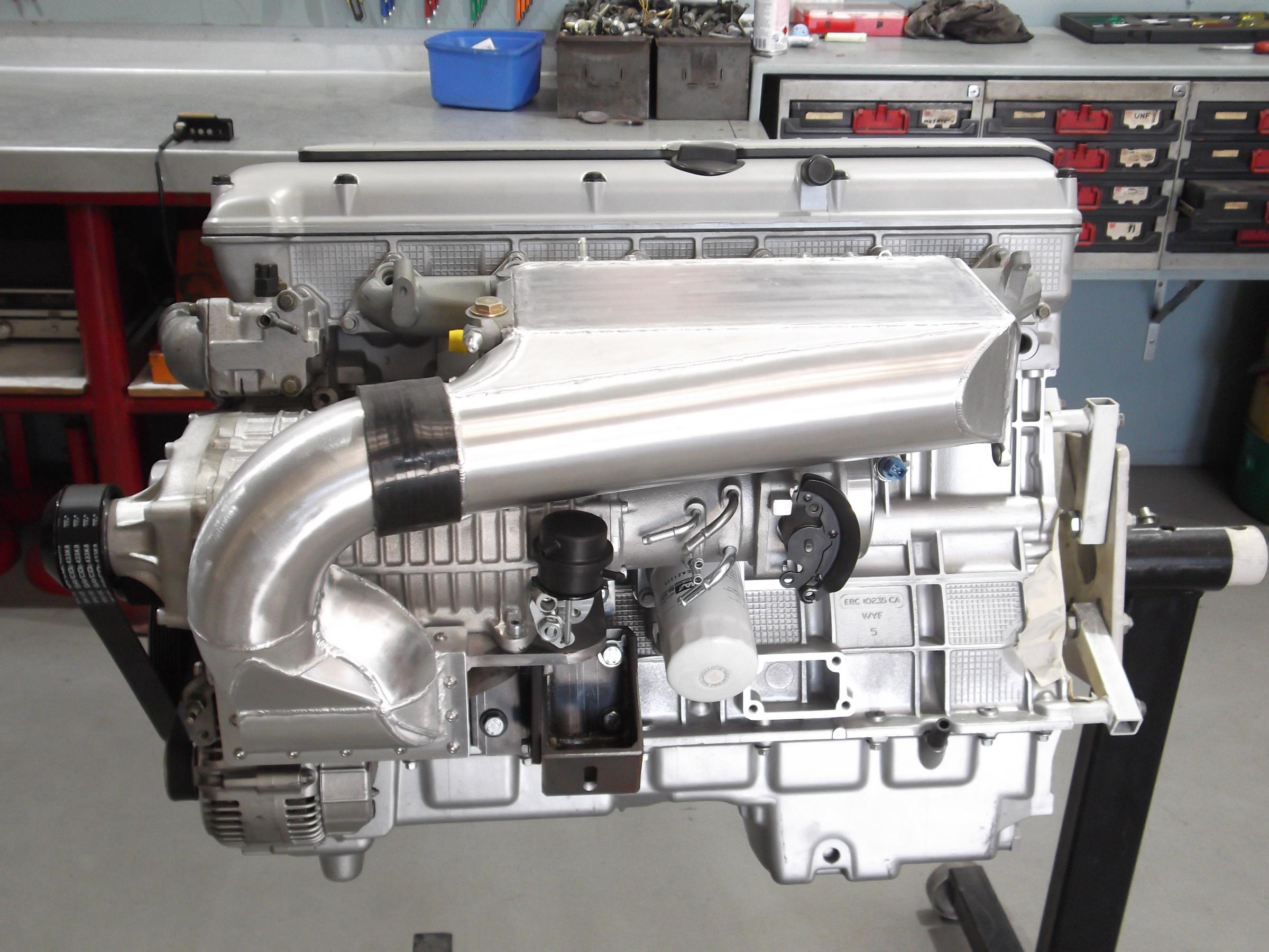

I would never use reground cams
I did that to my old 450 merc 3 months later one of the lobes was gone and so was $1000 ended up buying second hand set of rare AMG cams also a $1000 expensive learning curve
There was a member of the old XJR6 forum that did some searching and found a company in the UK that did new blanks you just needed to supply what specs you wanted on the grind
I would have someone over here interested in a set of cams he is building a monster aj16 engine with 2.3 twin screw massively ported head and custom pistons and con-rods
I just did a set of headers for him and he was asking me for a set of cams
