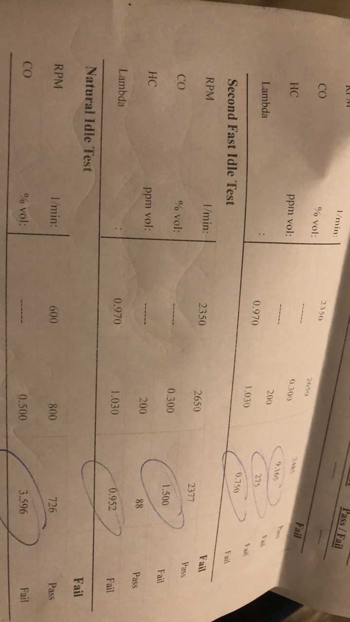

Mot emissions high
so mot today and the old girl only needed some adjustments to headlights and a couple flexi brake hoses but the main issue was the emissions
lambda readings up and down and running rich

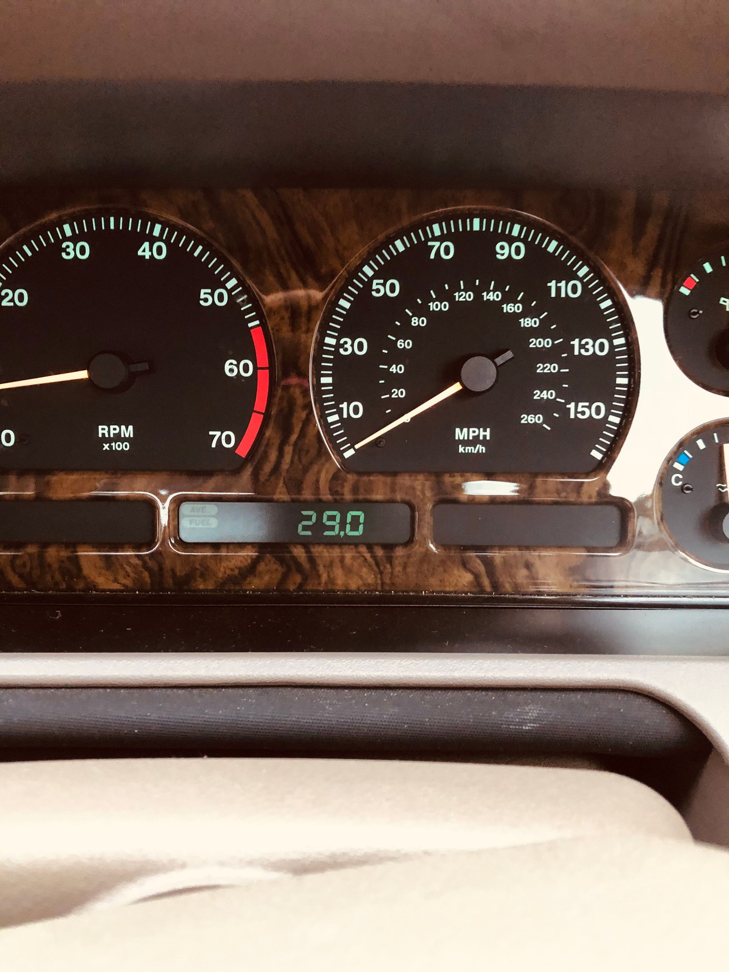

Just been and stuck some petrol in and thrashed her about and indeed it’s like a different car ,sounds better pulls harder and even spun the wheels in 3rd when I kicked down ...fingers crossed and thanks 👌🏻
oh and .....
after a five mile drive to the petrol station at a cruising speed of 55 this was my mileage reading ...8mpg more than the usual trio there 😳I’ve cured something for certain ......

With a cracked manifold the Fast Idle tests produced a fail on CO ( reading 2.81% volume) and Lamda (reading 0.925). HC was a pass although a little higher than previously.
