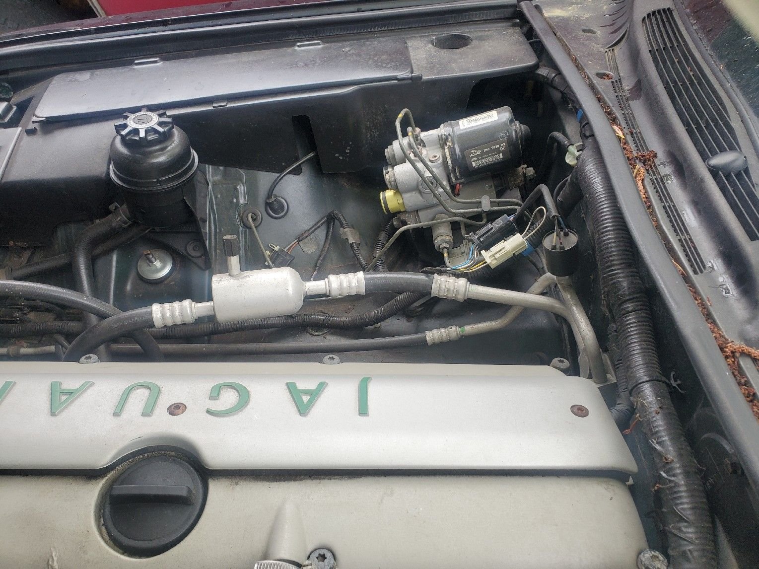

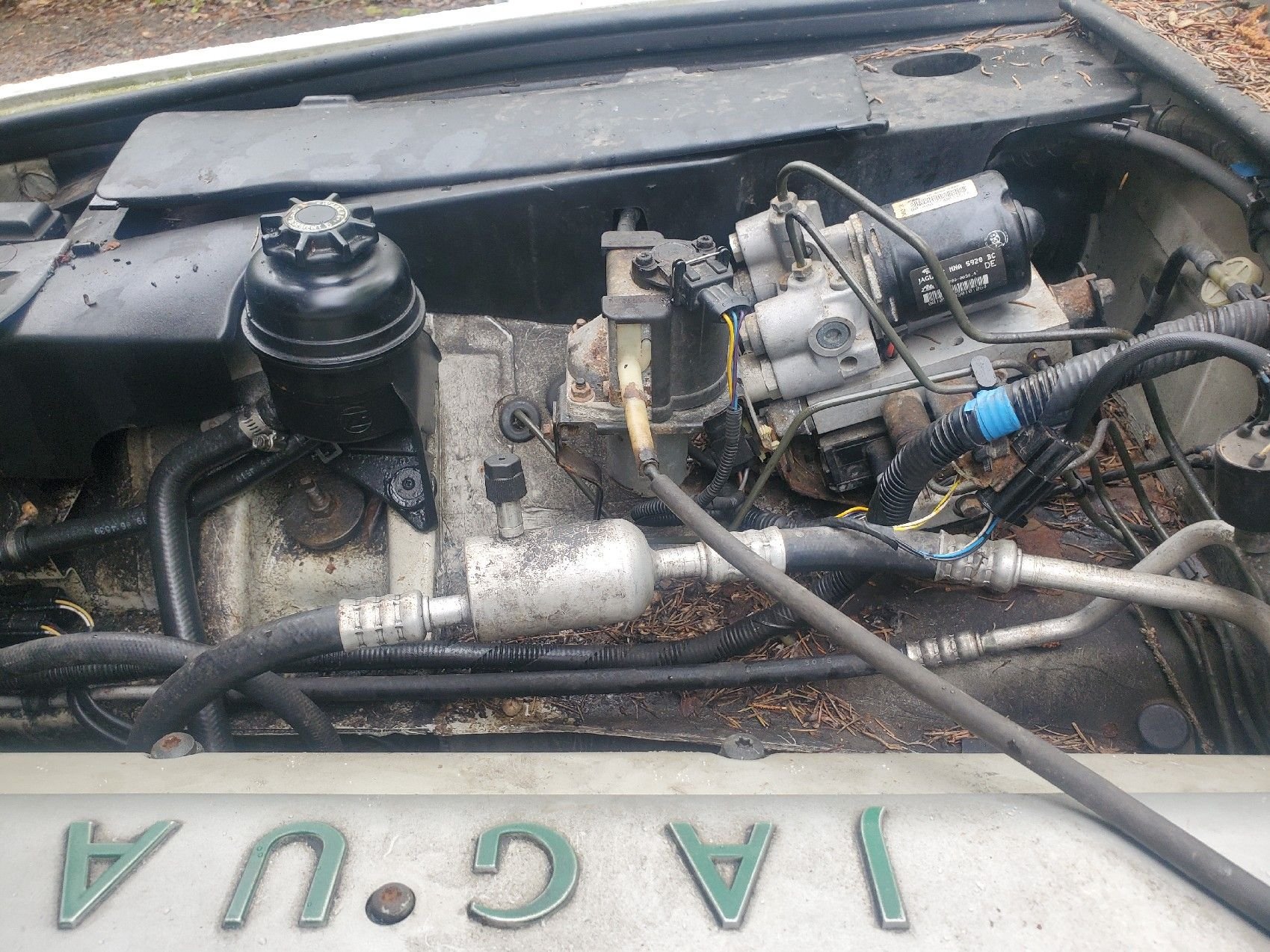

Now when I was working on the VdP to get it running again after a year or more of sitting in the backyard of the previous owner I noticed some differences in the engine compartment between the two cars.
Specifically something with the throttle cable routing.
1996 XJ6 throttle cable routing
The 1996 throttle cable and housing goes pretty much direct from the driver's side of the firewall to the throttle pedestal.
And the passenger's side inner fender is clear of "extra" devices.
1996 passengers side inner fender
1996 passenger's side inner fender

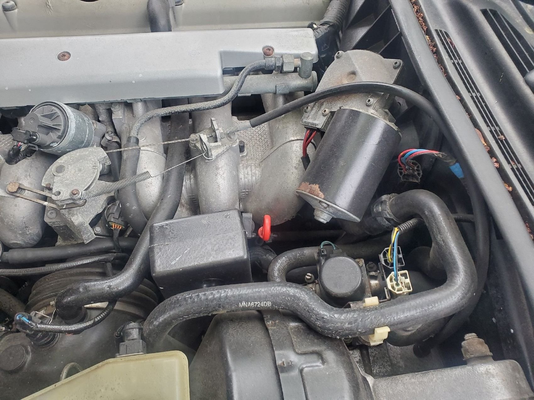

The 1997 VdP has a completely different throttle cable arrangement.
1997 VdP throttle cable has extra device over on passengers inner fender
1997 VdP throttle cable has extra device over on passenger's inner fender
On the 1997 VdP there is an extra device over on the passenger's inner fender and the throttle cable starts from the normal outlet on the firewall, arches over the cam cover to this extra device and then routes back across the firewall to terminate back at the throttle pedestal again.
1997 VdP throttle cable weirdness
What is this extra device over on the passenger inner fender and is this weird arrangement because the car is a 1997 (vs the 1996 car) or is it because this is a VdP vs the standard XJ6?

It is called TRACTION CONTROL.
It is not a MY difference but optional on various models.

Yes. The position sensor on the unit can fail or get OUT OF RANGE to set DTCs with ABS (C codes)

That cable assembly reduces throttle input if wheel spin is detected. Careful of the yellowed plastic cable guide, it will be fairly brittle. Notice the brake system device next to it is different too, it has a TC brake modulating valve assembly.
The rear seats should be different between the two cars, with a shoulder belt for the rear center passenger on the 97.
