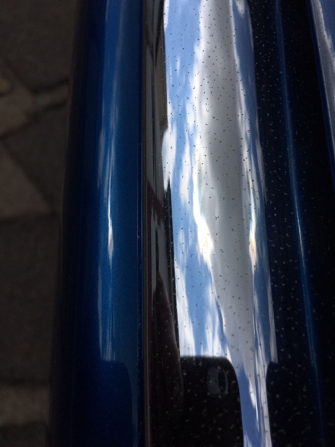

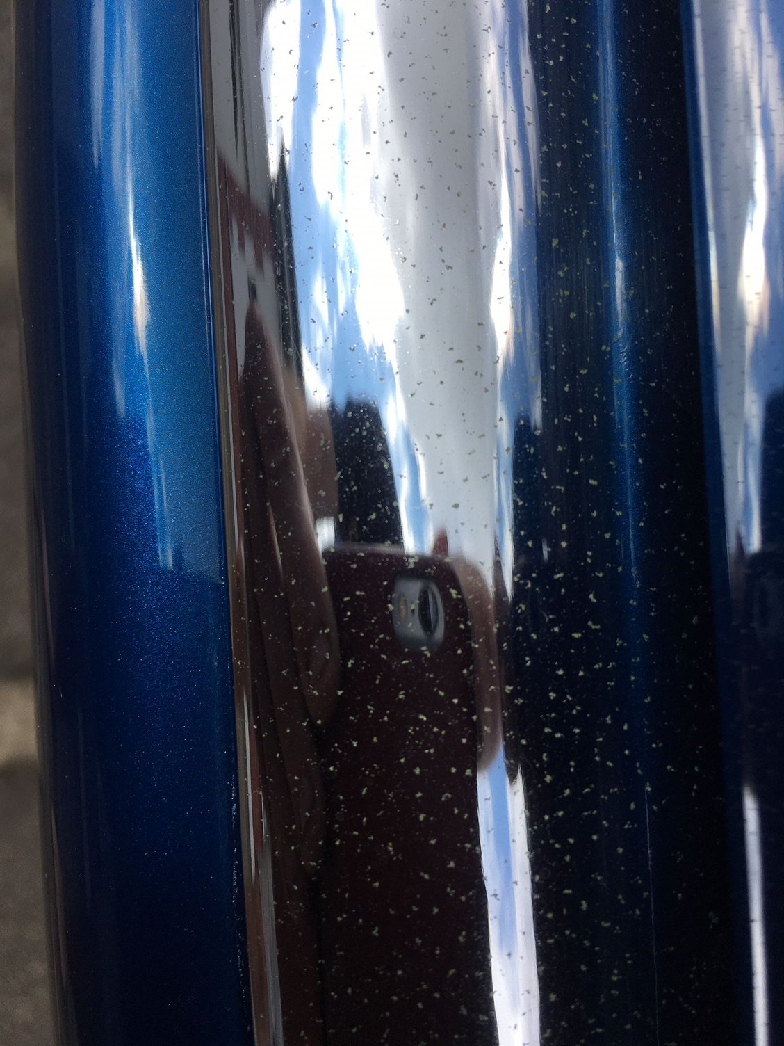

Default Photos Of Pitting
Old Jun 16, 2020 | 05:11 AM
johnnysh's Avatar
Joined: Jun 2020
Posts: 6
From: London
Default Polishing Stainless Steel?
Hi Guys
Ok so being stainless steel, they should not have gone like this even in storage surly ? I though stainless steel was stainless ?
Also the metal round the door windows, that looks like stainless seems ok and not pitted
I have tried at the weekend Autosol Metal polish, but best result I can get is whats in the photos, not acceptable with my standards
I guess the only solution, is to take them off and have them professionally polished, if they can get them back like new ?
Don't really want them polished in place for fear of damaging the paint work at front and rear of car
Again any help much appreciated
Regards John

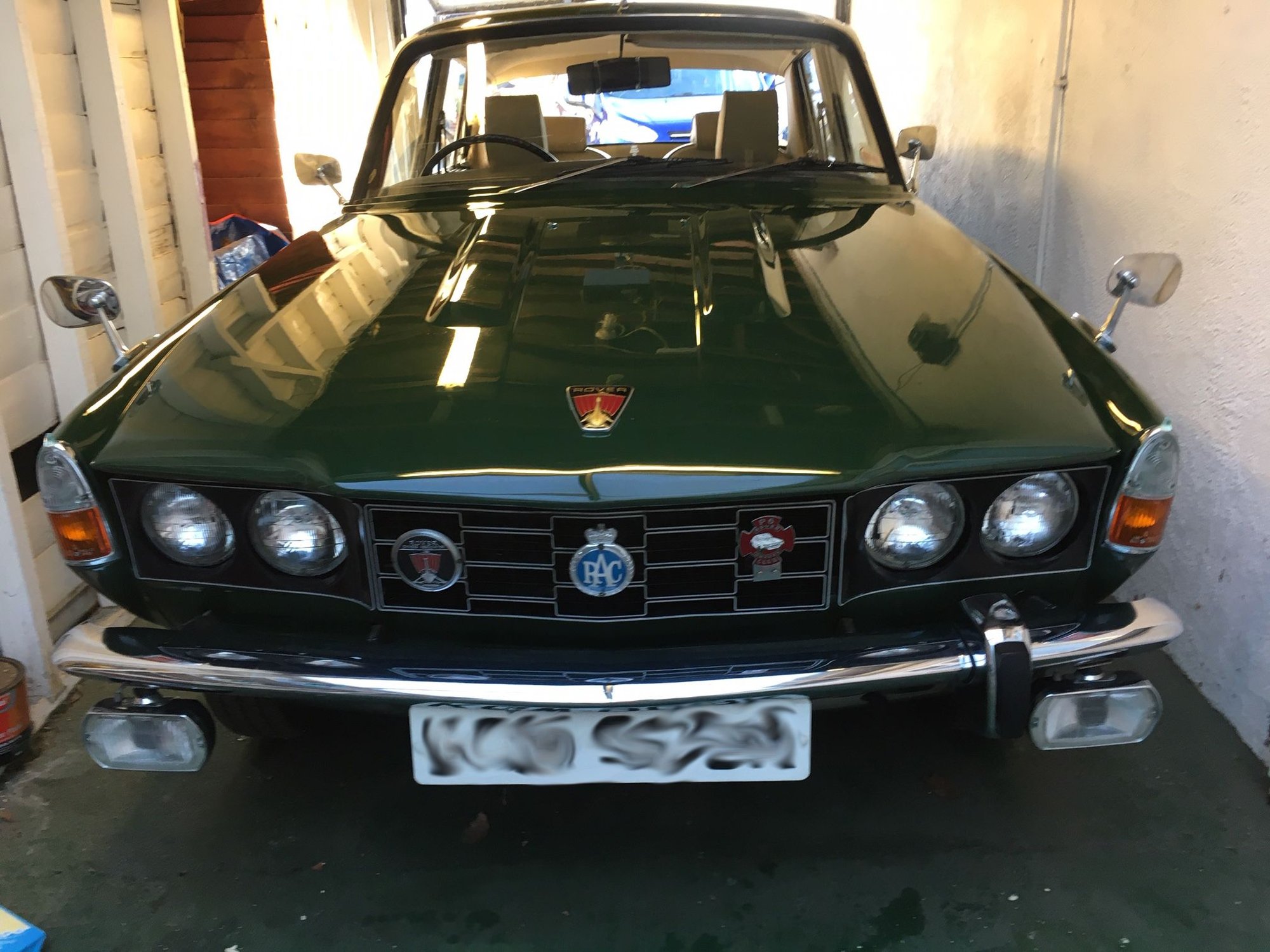

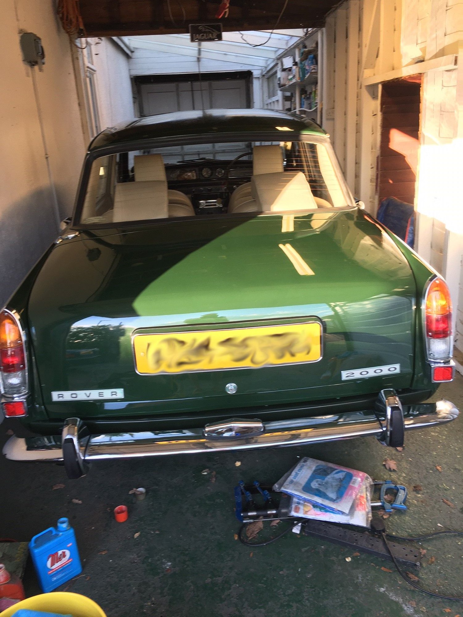

The other car that was in the garage is my fathers 1972 Rover, I spent Saturday valeting this car, The car has only done 25,000 mile from new
I will be selling this classic, again the bumpers have suffered pitting, but these are real chrome not stainless steel
She is a beauty, and need to go to a Rover P6 Enthusiast, she has been garaged all her life and there is no rust top or bottom :-)

Well, it is definitely an X300, and that definitely looks like pitting!
Unlike chrome, where the pitting usually represents holes in the layer of chrome, through to the nickel or steel below, these bumpers are solid stainless, so there is something to polish down to without compromising the finish. Autosol hasnt done the trick, but there are various metal polishing attachments for an electric drill which could sort this. The discs are almost like thick canvas and with a little compound on them should shift the marks on your bumpers.
That is a lovely P6. Very unusual to see one with the correct factory accessory rear head restraints. Lovely colour trim combination. I am wondering whether the rear badge has been replaced at some point, as should it not say 2000 TC?
Does she have the box pleat seats or the earlier, and better quality "flat" seat faces? A real gem, and fantastically low mileage.
