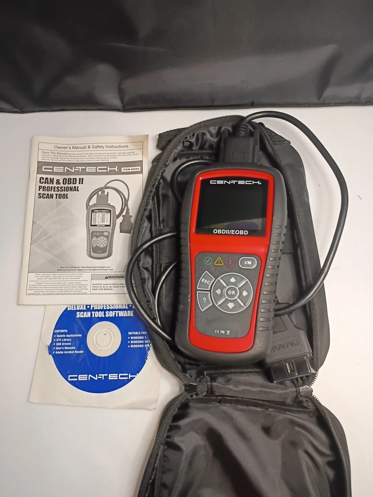

I am trying to read codes from a 1997 VdP and a 1996 XJ6, bith of which have a check engine light displayed.
I have tried a dedicated OBD2 scanner tool that I purchased years ago from Harbor Freight (Cen-Tech brand) and using scanner software on a laptop with a USB based ELM dongle.
Both of these methods produce "no codes present for both stored and pending.
I know the OBD2 port is powered since the Cen-Tech scanner powers up when plugged into the port.
Anyone have any suggestions as to why I am unable to read codes?
Picture 1 of 4
This is the scanner I have from Harbor Freight.

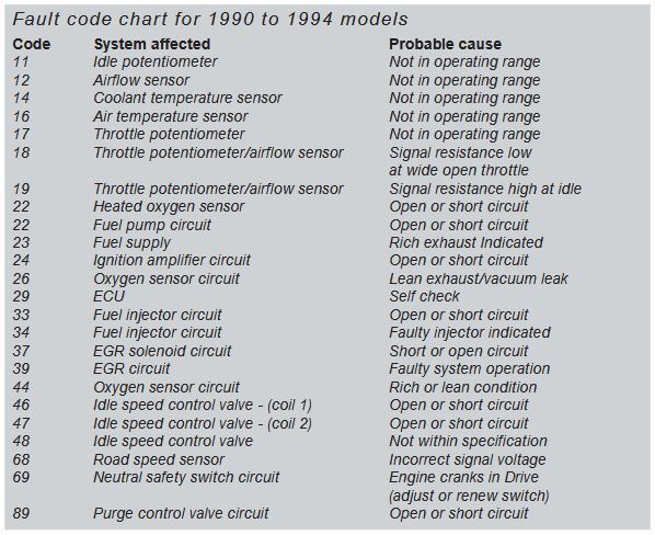

Don B's Avatar
Posts: 20,549
Likes: 15,313
From: Crossroads of America
Originally Posted by KAHB
The code reader I have is designed to also work specifically with Jaguars/Rovers. However I am getting error codes that begin with "FF" but cannot find any reference to them anywhere, even on the web. I assume they are Jaguar proprietary codes that Jaguar won't release to the public. Does have access to what they mean?
The previous Jaguar saloon, the XJ40, had a proprietary OBD1 diagnostic system. The diagnostic trouble codes were read by turning the key to the RUN position without starting the engine, then pressing and releasing the VCM button (Vehicle Condition Monitor). DTCs would display one at a time in the form of "FF" or "Fuel Fault" and a two-digit number. Here's the chart for the later XJ40s:
Cheers,
Don
